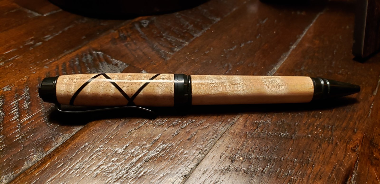

So I turned a tiger maple pen with ebony inlay and ended up with smudge marks on the maple. Any ideas on preventing this? Used new sandpaper when I sanded the blanks.

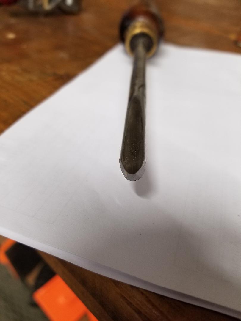

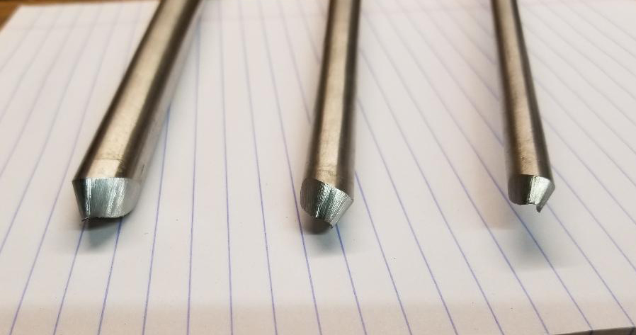

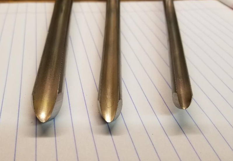

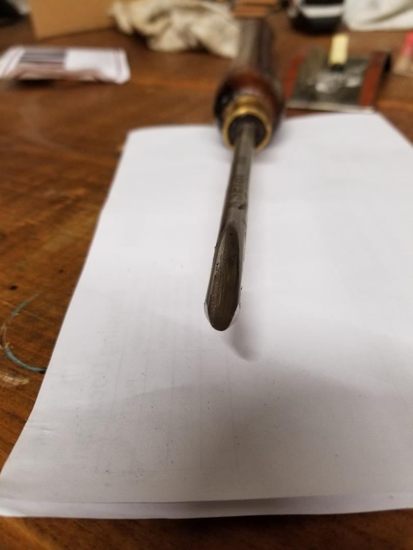

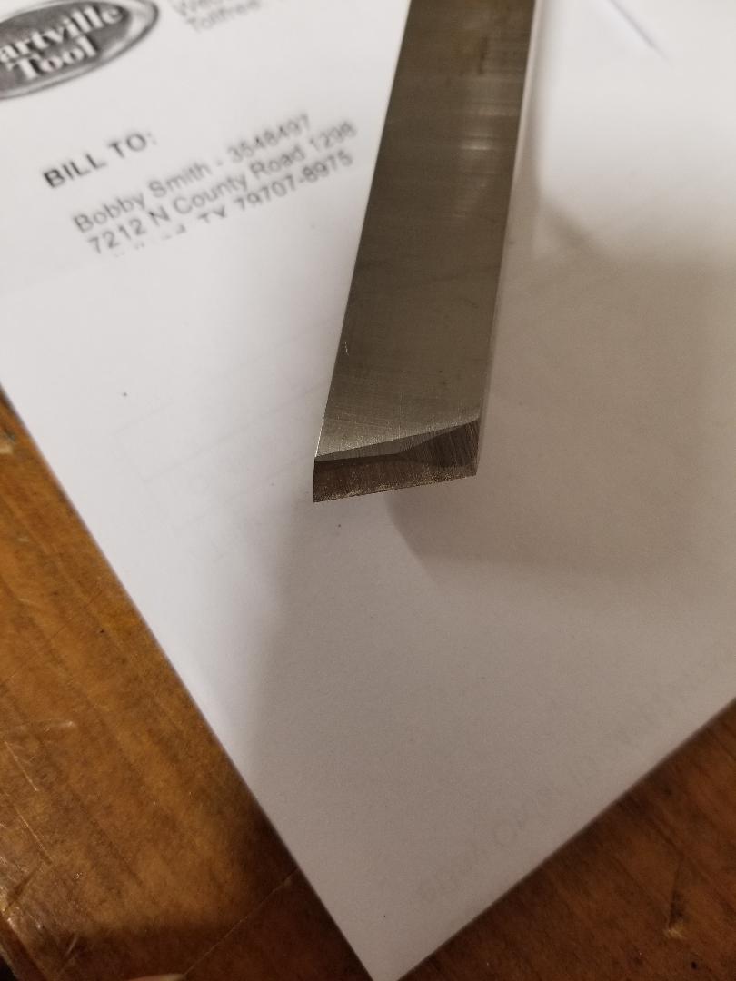

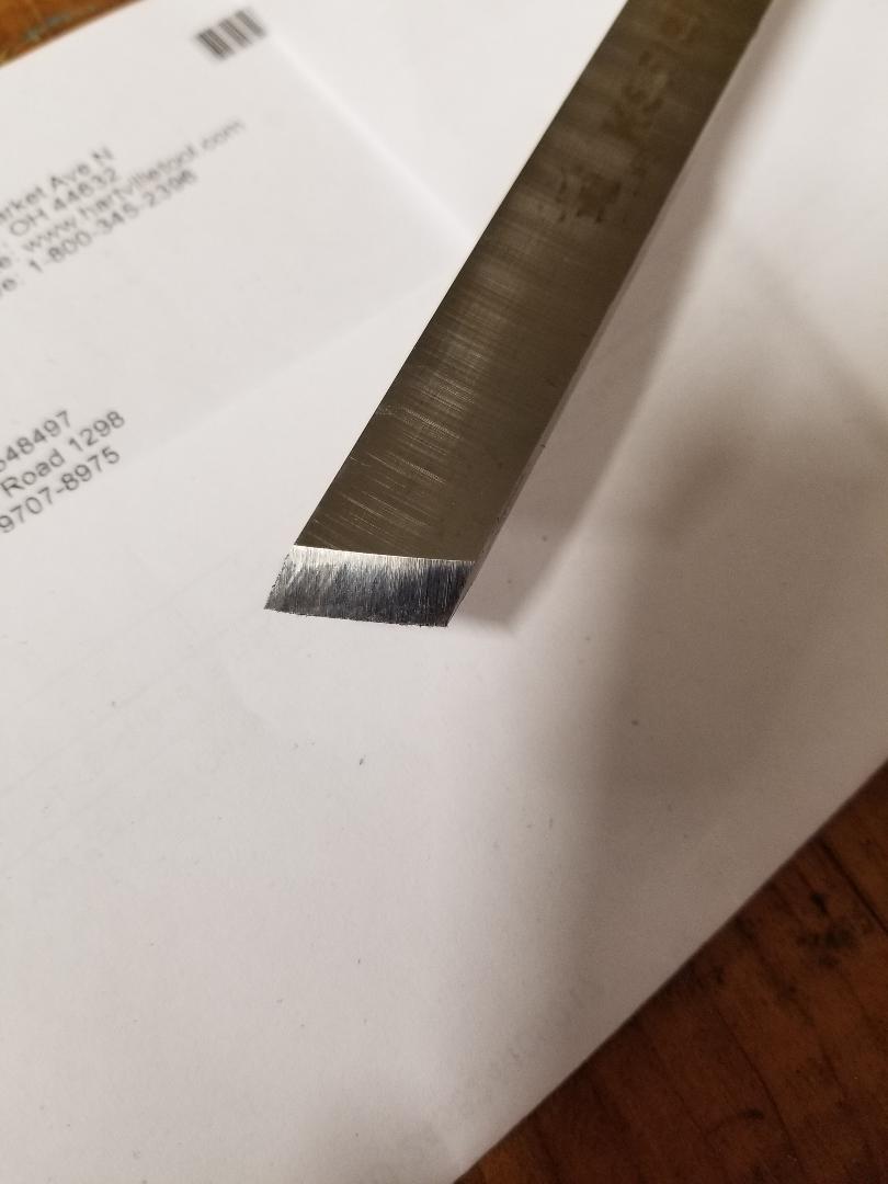

I definitely had problems with sharpening my tools. I bought recommended wheels for my grinder, even bought a variable grinder and I just didn't have what it took to get a good sharpen. I broke down and bought me a Sorby. A little expensive yes, but these were my results first time out of using it. Never been happier. I keep it setup so I can just go over and do a quick sharpen when I'm turning now.

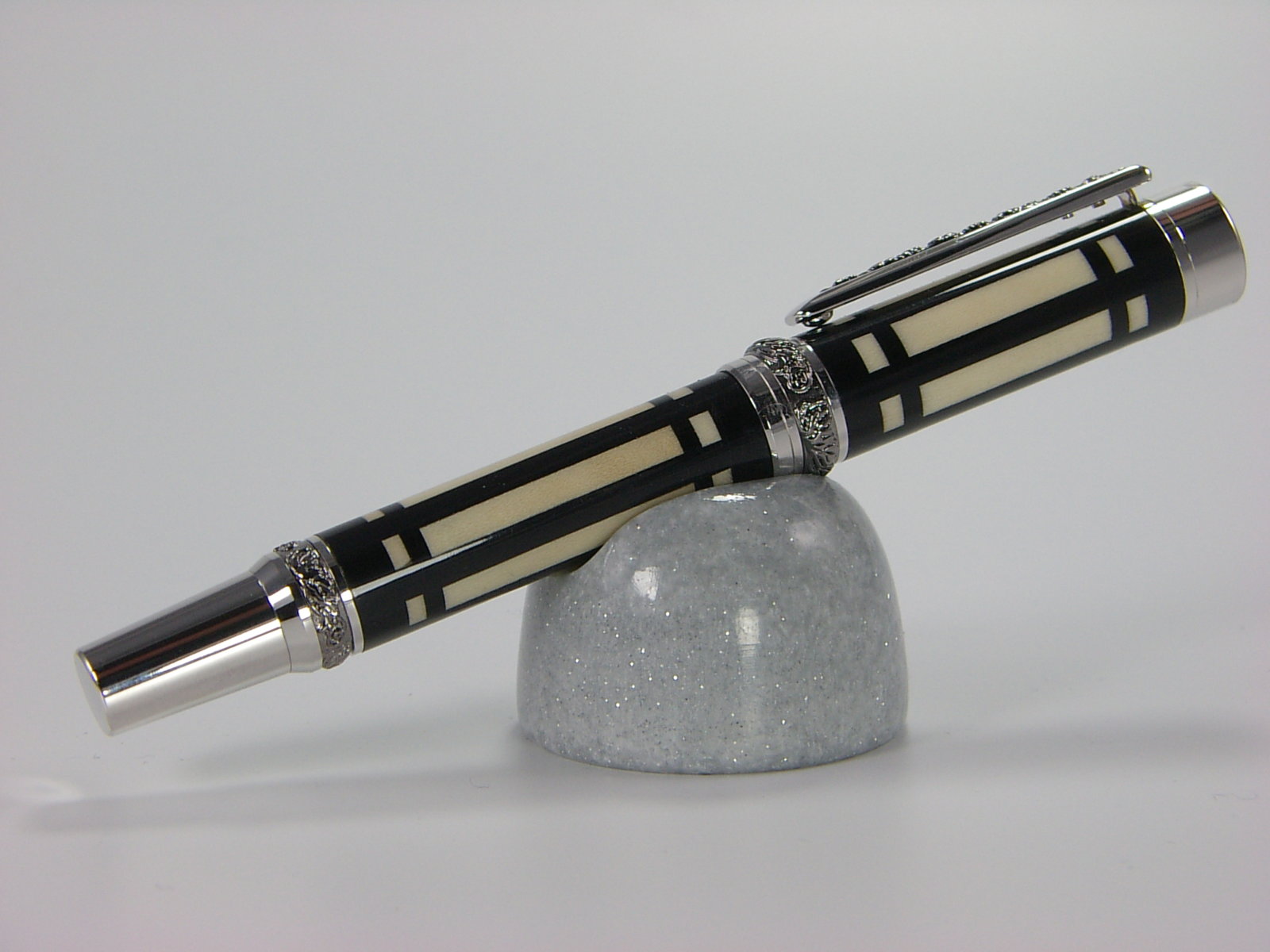

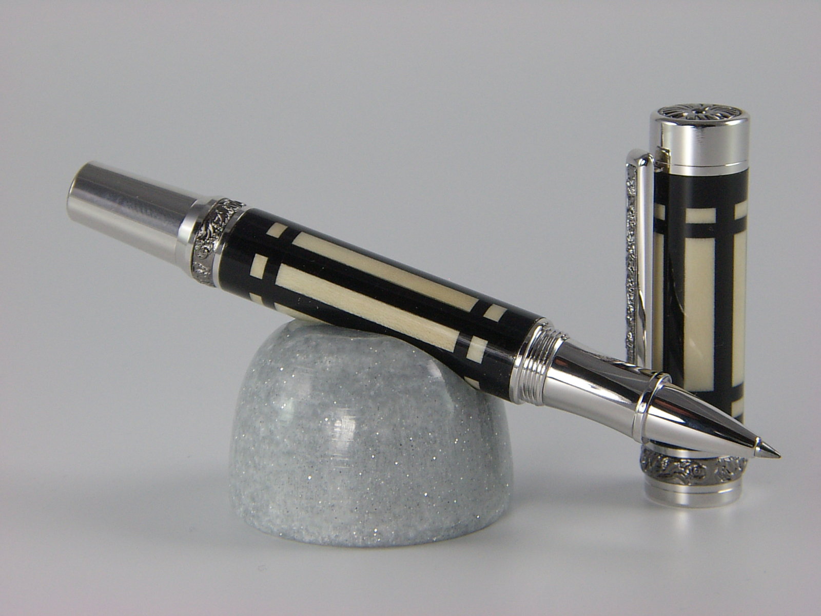

I have said this many many many times here and will continue to for I am a proponent of the use of the skew. A well sharpened skew is the answer to many of these problems when it comes to segmenting different woods or materials. There is no way I would have been able to use sanding sealers or anything without smearing the colors of woods because of the pores. This pen is an example I mostly show but have used other woods that are just as bad. This is done with Gabon Ebony and Holly. It was finished with a skew and to final shape and no sanding. I sprayed a quick coat of clear shellac to seal and then went to the CA finish. I did notice there was a slight bit of color change with the Holly but being I bleached it before I did any turning or building of the blank it was pure white and this gave me a chance to keep that white look. Always test your scraps before doing any finishing.
