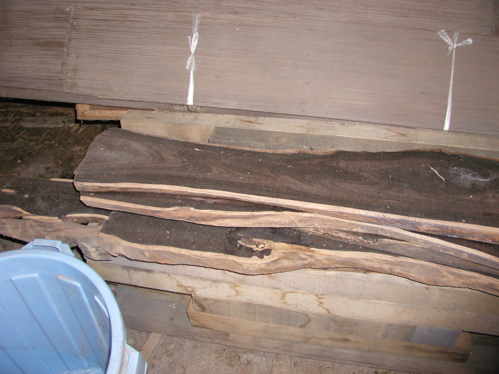

Below is a picture of some persimmon ebony boards about 6 ft long, 8 inches wide, 2" thick that a Japanese friend paid the equivalent of $800 per board back in 2003. When finished, the wood is very black in appearance, and oily! It will crack if left in the hot sun.
