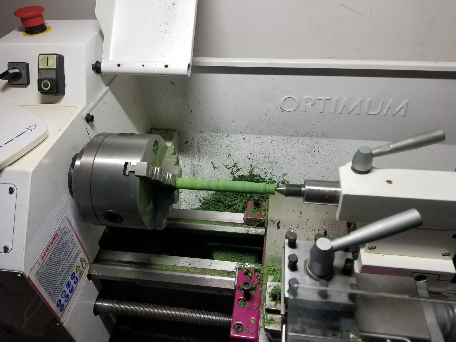

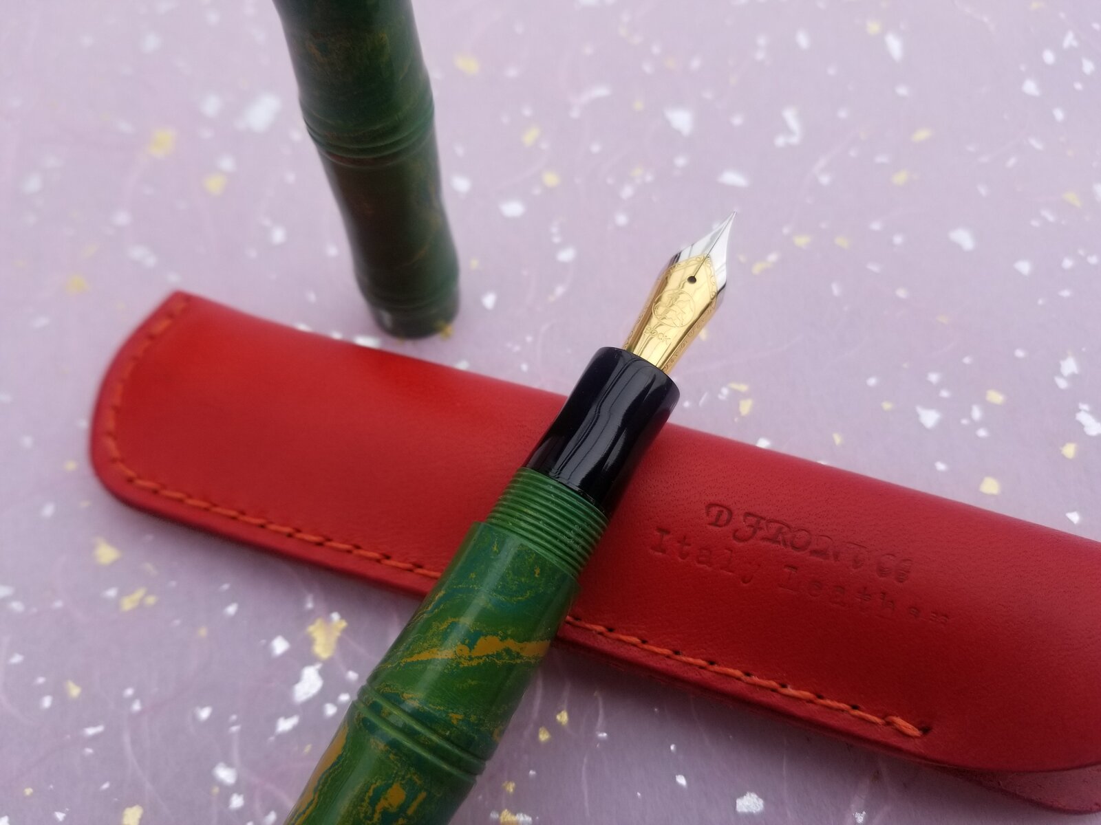

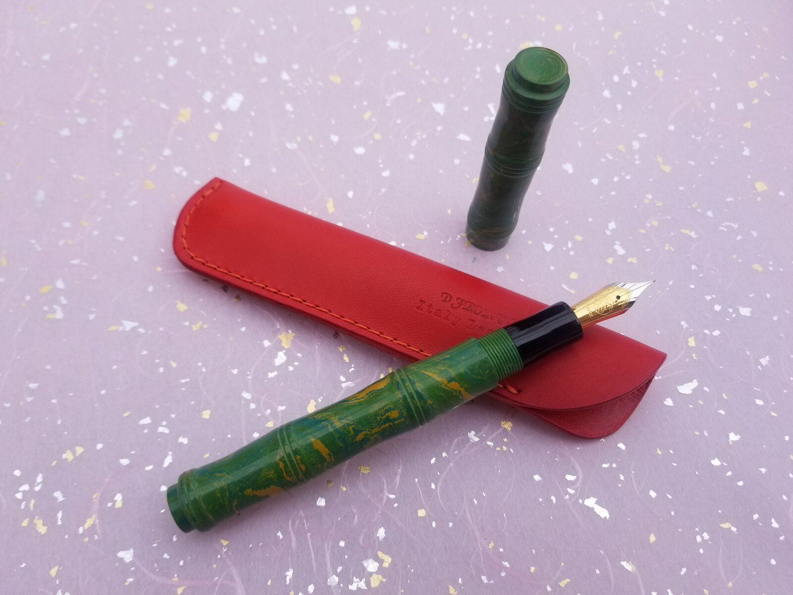

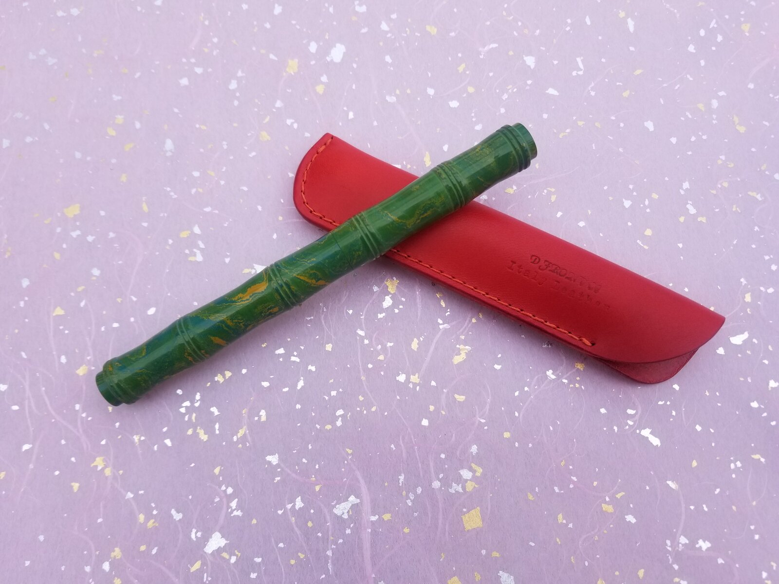

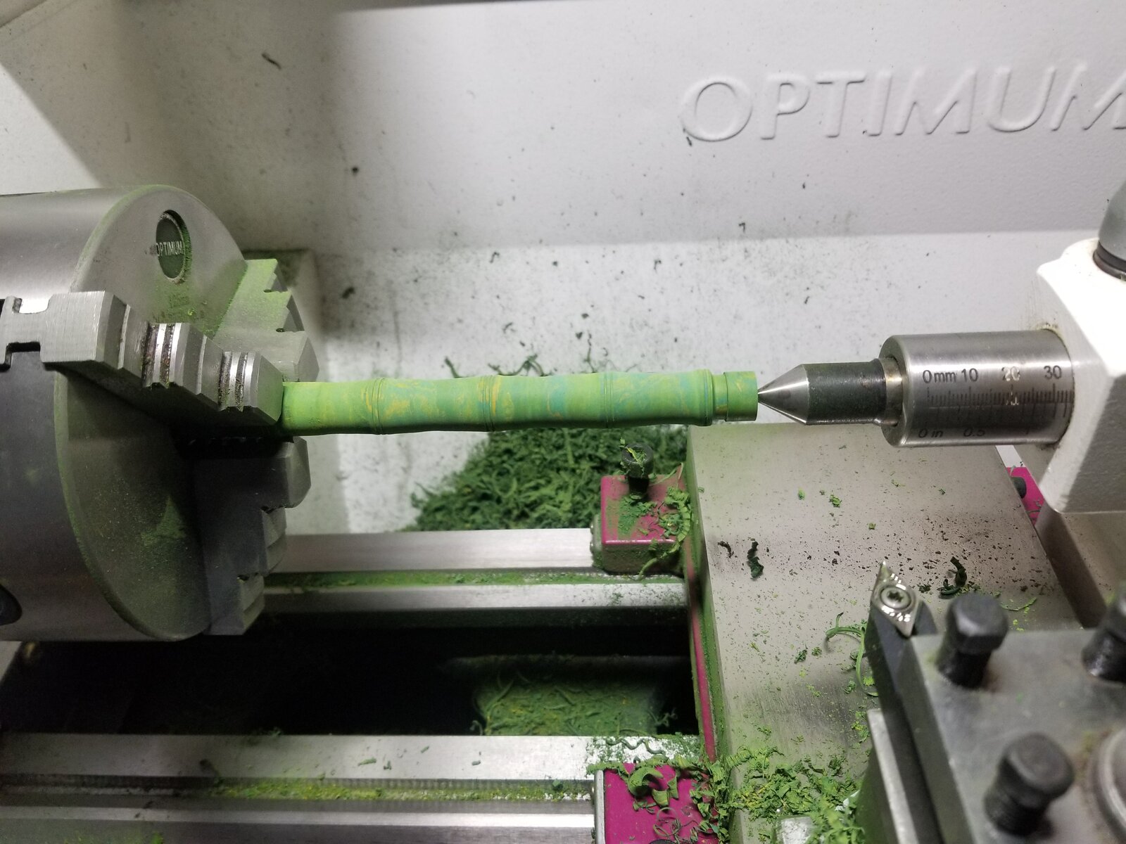

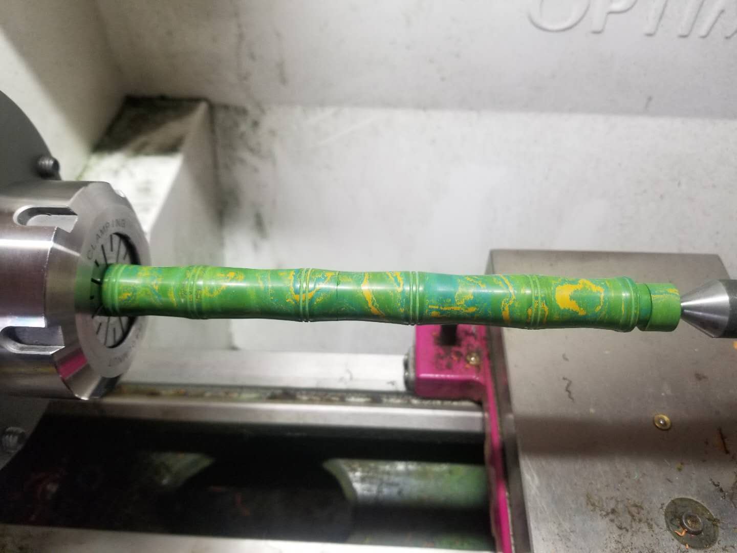

我最近有时间用黄绿色的硬石竹制6#笔尖制作竹笔。进行硬石抛光时,我使用湿至5000#的砂纸(湿砂纸抛光至高眼球,更容易抛光,也节省了时间。抛光使用名仕树脂蜡和法兰绒轮。

Looks good. I like the bamboo shape. Did you do the curves free hand with a tool rest and hand tool?
Yes, I use a round turning tool, and then adjust the lathe to the taper of the car, and change the other end when the car is in place.
