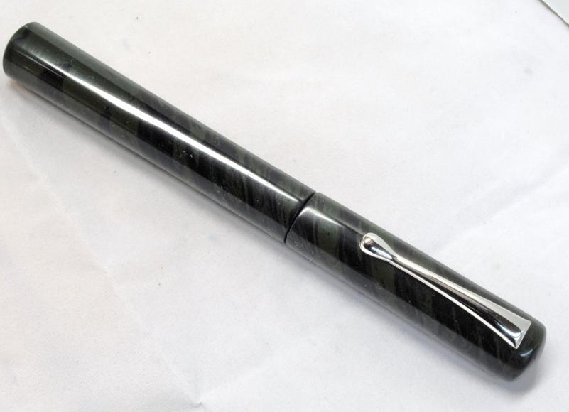

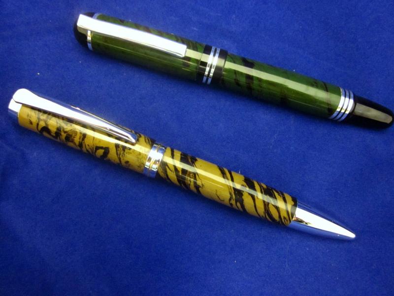

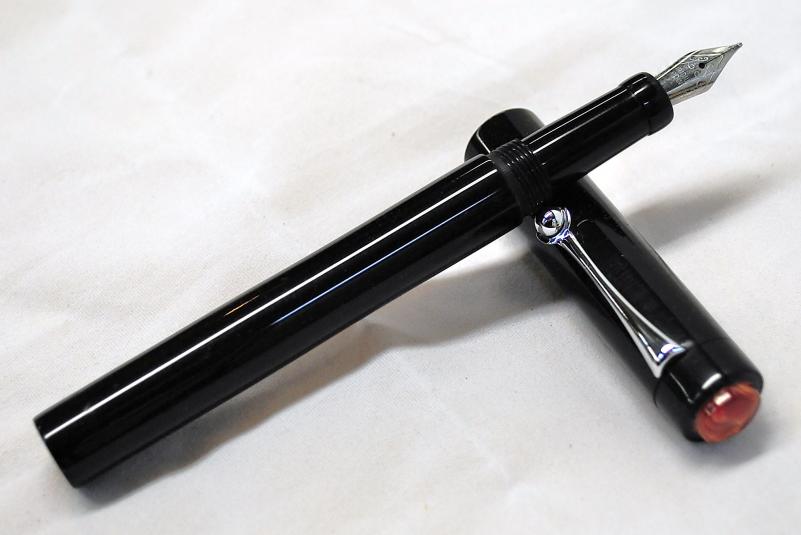

Here ya go. That green/black doesn't like to have its picture taken.

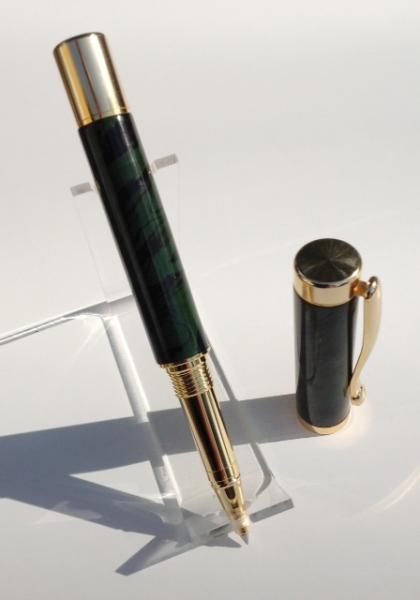

Yea a few small ones i haven't used to much of it. Not to bad, Here is one i did in the green on an Atrax. Looked though some others sticks and closed end barrels and didn't see any.
Don Vann
