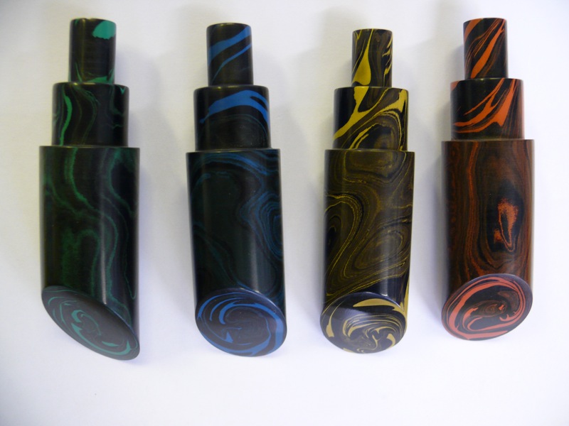

Actually this is a group buy price from pipemakersforum.com
They just did a group buy for the black and may be doing one for the swirl material. The price I quoted is straight from their buy, but I do have the manufacturers info now too.
Here's the pic that they have of the stuff

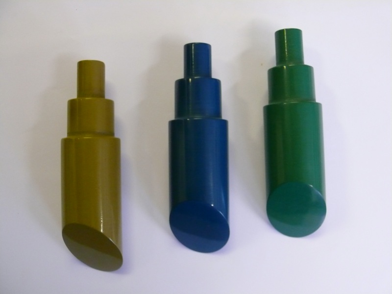

for those that haven't seen a pic of the solid color material, here's the one Kurt posted over at pipemakers.
And from their website, it looks like they have about 30 colors.
