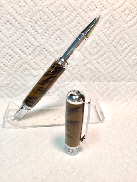

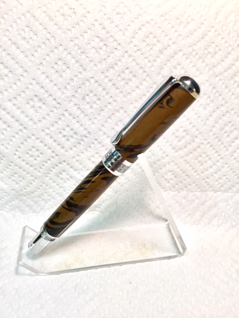

liljohn1368 Member Joined Jul 19, 2015 Messages 2,284 Location Brooksville, MS Oct 29, 2016 #1 This is my first ebonite. It turns great but the smell is a bit harsh. I finished it with MM and some buffing compound. Thanks for looking. C&C welcome... Attachments ebonite 2.jpg 110.1 KB · Views: 373 ebonite 1.jpg 105.8 KB · Views: 424
magpens Member Joined Feb 2, 2011 Messages 15,907 Location Canada Oct 29, 2016 #2 Good for you, JP !!!! . You were asking about Ebonite ... you did a great job with it !!!!

liljohn1368 Member Joined Jul 19, 2015 Messages 2,284 Location Brooksville, MS Oct 29, 2016 #5 Thanks, Mal, Jim, and Michael. And everyone who liked my post. The ebonite turned great. I got it in the October PITH from truckfixr. He sent me one more piece That I think Imay do me a pen out of.

liljohn1368 Member Joined Jul 19, 2015 Messages 2,284 Location Brooksville, MS Oct 30, 2016 #7 Thanks for the compliment, Bob....
edstreet Member Joined Aug 12, 2007 Messages 3,699 Location No longer confused.... Oct 31, 2016 #8 The secret and key to using ebonite is HEAT MANAGEMENT. The hotter it gets the more it smells.
Sataro Member Joined Mar 15, 2009 Messages 3,623 Location Mexia, TX Oct 31, 2016 #9 Very nice looking!
liljohn1368 Member Joined Jul 19, 2015 Messages 2,284 Location Brooksville, MS Oct 31, 2016 #10 edstreet you are exactly right. While I was turning it, it smelled awful. Thanks Billy for the compliment.
edstreet Member Joined Aug 12, 2007 Messages 3,699 Location No longer confused.... Oct 31, 2016 #11 Get you a super sharp round nose scraper. There will be no smell.
liljohn1368 Member Joined Jul 19, 2015 Messages 2,284 Location Brooksville, MS Oct 31, 2016 #12 When I swapped to my carbide tools it helped also.
