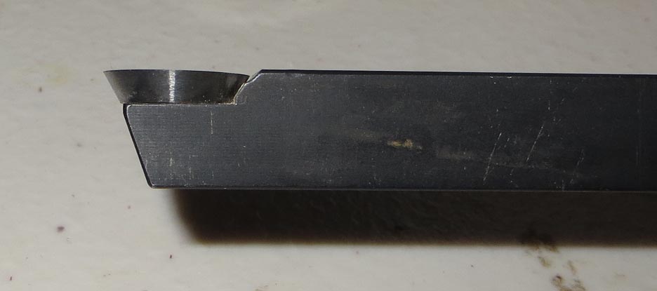

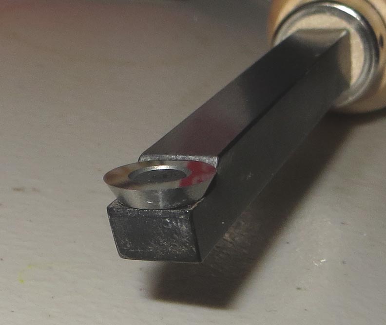

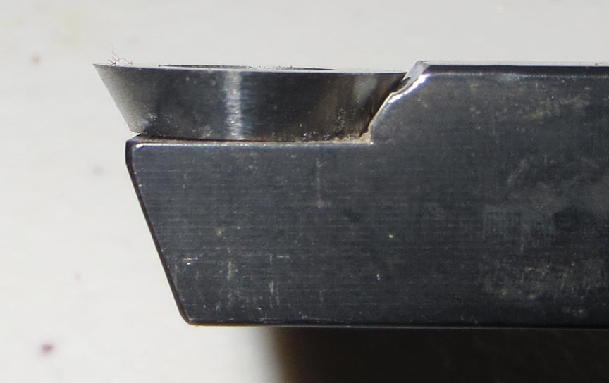

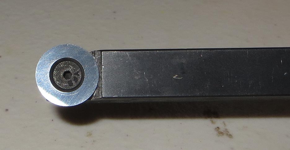

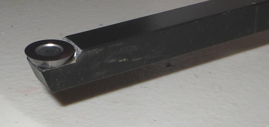

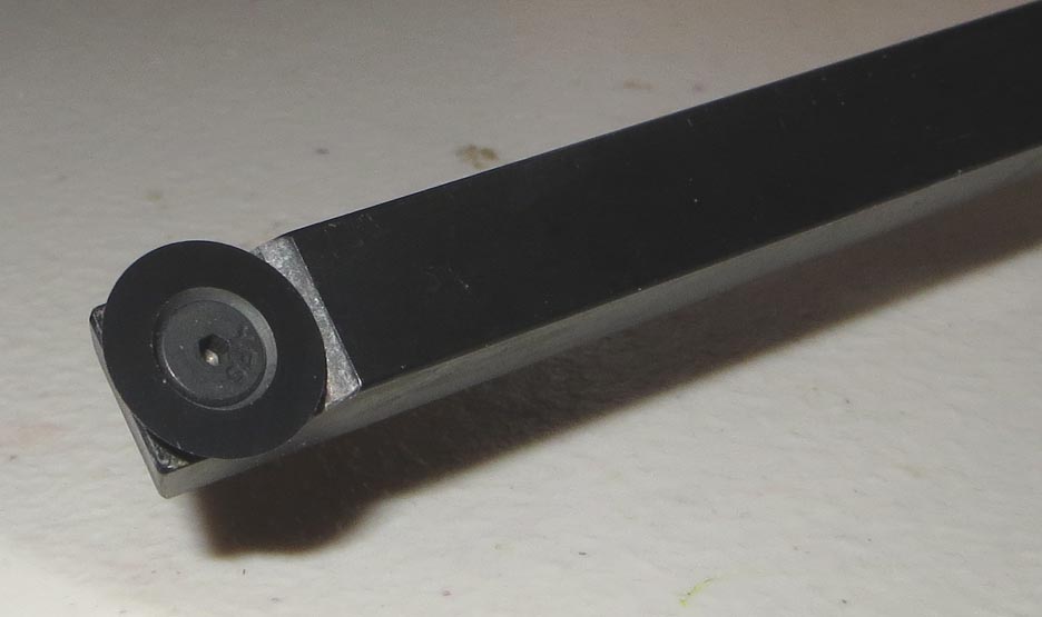

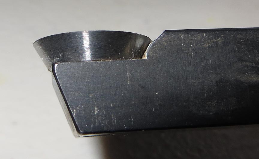

For carbide tools, yes, you don't want the bar itself to touch the work piece, so some relief is required.
You want as little metal down there as is needed to secure the carbide bit, but you want to make sure that thing wont go ANYWHERE.
As long as there's clearance below the cutting edge, and room for the shavings to clear the bar, you should be good to go. Making it look pretty isn't absolutely necessary, but avoiding cuts from handling your tool is a major consideration for leaving smooth surfaces behind.
Also, on the back side of the cutting insert, you don't want that to touch the bar either. Excessive force or vibration could chip the insert. You also don't want such a large gap that while you are cleaning the tool off, you gash your hand and fingers open. I'ld say half a millimeter to 1 mm should be good, but you should still mind those sides and edges .... I prefer grabbing an old paintbrush to clean off my carbide cutters.
qquake
Feb 8, 2004
5,023
Northern California

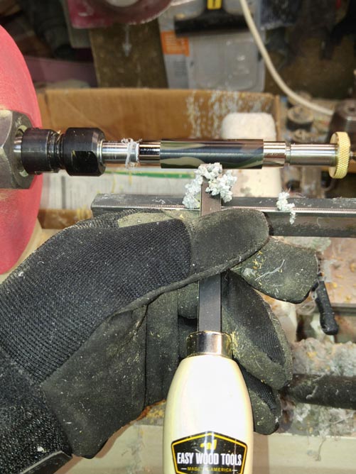

As far as I can tell, the back of the cutter isn't touching the bar. When I first got this tool, I cut my thumb on the side of the radius cutter. I have a habit of raking the shavings off the chisel I'm using with my left thumb. So I took to wearing a tight fitting mechanic's glove on my left hand. It also makes my hand slide easier along the tool rest, as that's how I gauge the depth of the cut.
