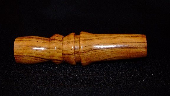

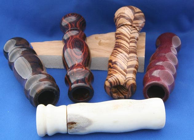

AS far as looks go - check out the duck calls below that have a CA finish - but not nearly as good as many others do here. But the CA is far more waterproof than any of the other furniture finishes listed above.

I haven't tried the CA/BLO finish on a pen yet.. actually haven't been turning pens lately... I did use CA/BLO on my game calls and while I didn't get your shine, I was pleasantly surprised with results.. with a little more practice... will definitely use the finish on future pens.

That is a nice looking call! Beautiful wood and clean design. I really like that!
