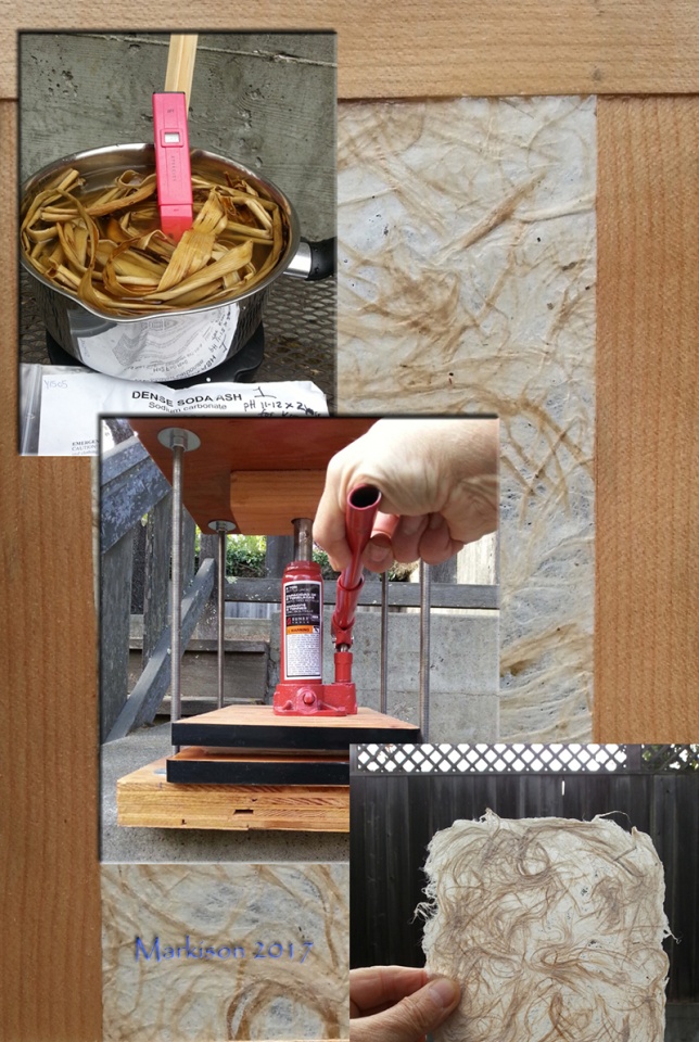

First I made some paper - here's the basic technique:
Thailand Kozo fiber simmered x 2 hours at pH10-11 (alkalinized with soda ash - all of this is done outside with proper safety precautions); then the fiber is rinsed very well, then beaten to a pulp with meat hammers, blended gently with some internal sizing (alkyl ketene dimer) to fine tune the water absorbtion properties), turned into sheets with a mold and deckle (standard washi paper making technique - and Helen Hiebert has written some great books explaining the techniques), then pressed the newborn paper between sheets of blotter paper with a simply-constructed 2 ton bottle press; then air-dried them:
attachment.php

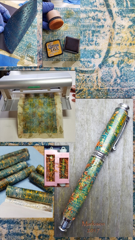

I was about to make a linocut depicting early people to block print onto the handmade paper - but then I found a very nice texture sheet on https://www.cooltools.us/ so i "inked" the texture sheet with Jacquard teal color iridescent airbrush acrylic paint, and transferred the image to the handmade paper with a 4" rubber brayer; blew the monoprint dry; then "ancientized" it (questionable verb) with Ranger Distress inks. I then airbush-sealed it with Createx clear top gloss acrylic, and blew that dry.
I then ran it through a Xyron Adjustable 9" Creative Station to apply a layer of permanent adhesive to the back of the handmade paper; cut the rectangles to size; then pulled off the backing and wrapped them around the acetone-cleaned brass tubes; airbrushed a final layer of Createx Gloss Acrylic onto the wrapped tubes (air-dried them x 2 days); then tube-in cast them with Douglas and Sturgess Clear Casting resin, adding some copper flakes in hopes of providing a (very) little bit of modesty to the early people; and finally turned and finished them as usual:
attachment.php

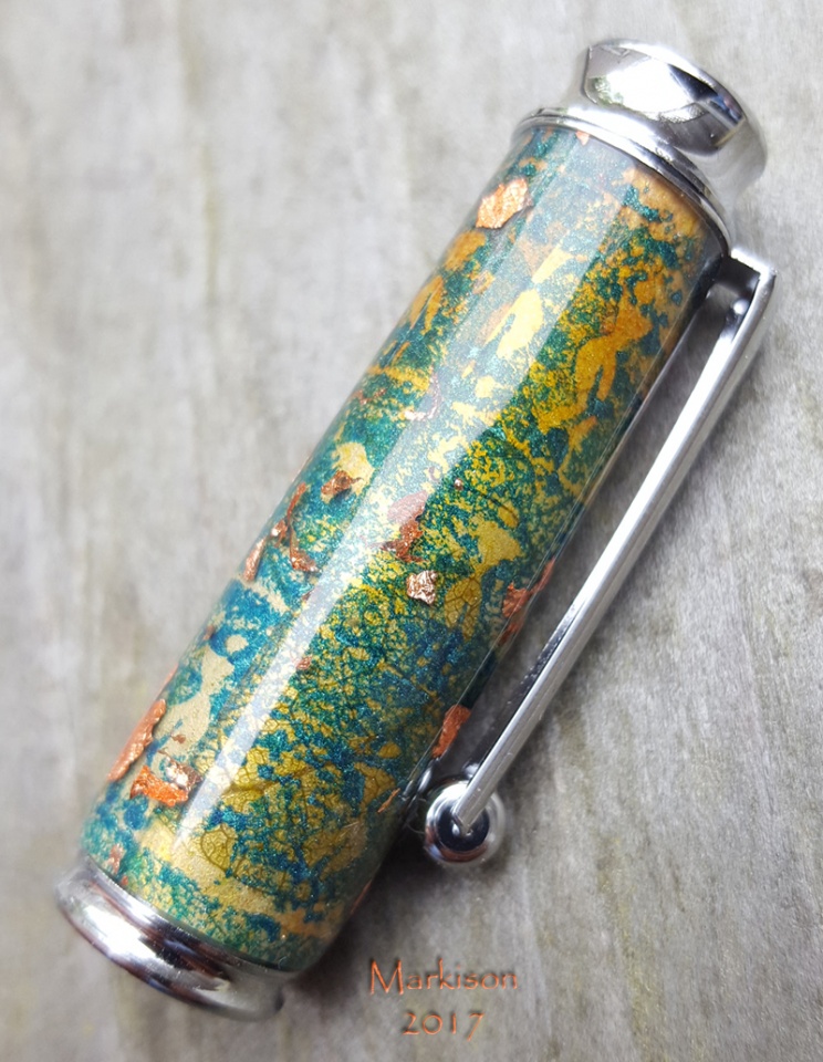

This cap close-up view confirms that the flakes provided minimal modesty (will try micro-fig leaves next time):
attachment.php

I'm curious about the copper flake, as I would think it would either float or sink, but it looks like it dispersed nicely around the blank. Did you have to manipulate it much to get that to happen?

Roy - the copper flakes play well with PR - just stir well and accept the randomness.
I pressure cast at 50psi.
