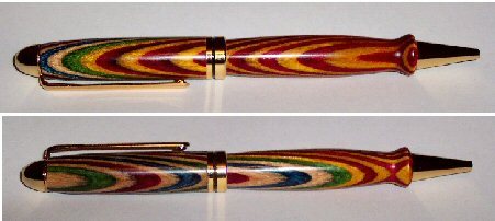

This was an experiment to see what a pen would look like if I glued up two different colors of Dymondwood on the diagonal . The picture is of the same pen from both sides . It's sanded to 1500 grit and finished with Turners Polish .

Nice pen Doug, I have good luck selling this material and it finishes nicely. Agreed Gregg, I tossed more blanks when I first started with this stuff. Anthony

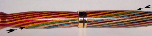

I love working with Dymondwood . The one thing that I've never had - YET- is a blowout .
I buy all my DW as straight grained and cut and re-glue to a diagonal pattern using "Hot Stuff - Super T" glue . Since the 2 surfaces to be joined are the outsides of the blank , the one thing that I did find out is that you HAVE to sand both faces with (at least) 80 grit sandpaper before the actual glue-up .
I've added a pic with arrows pointing to the transition point between the 2 woods and as you can see , it's virtually invisable and can not be felt either .
