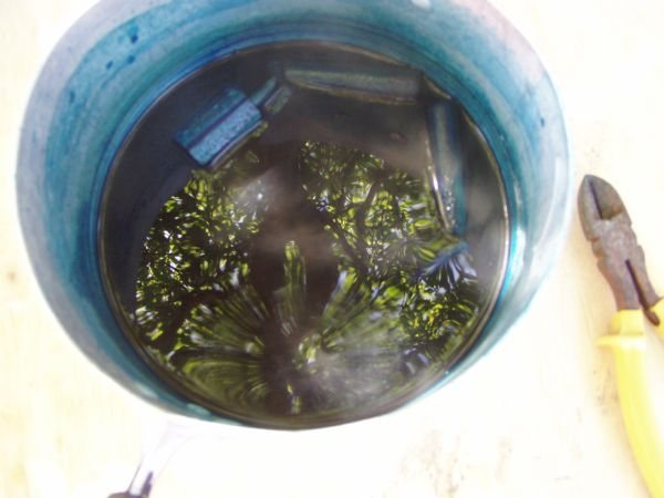

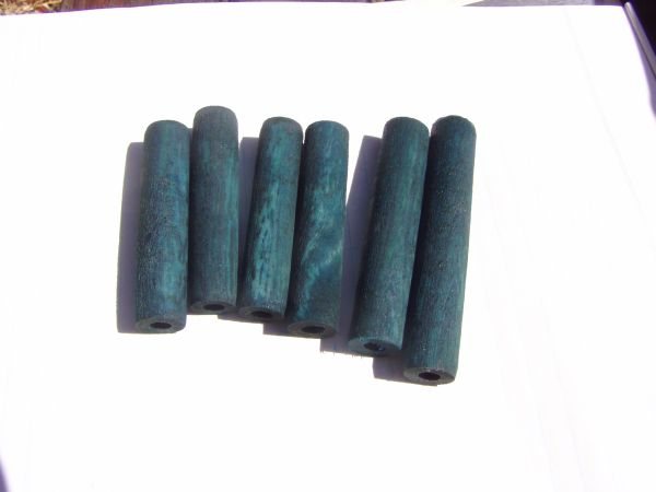

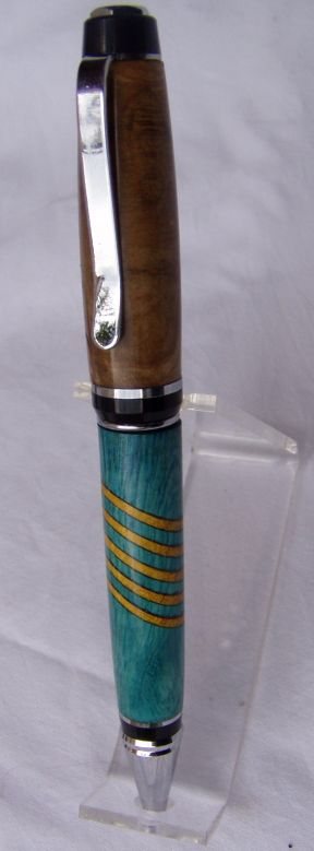

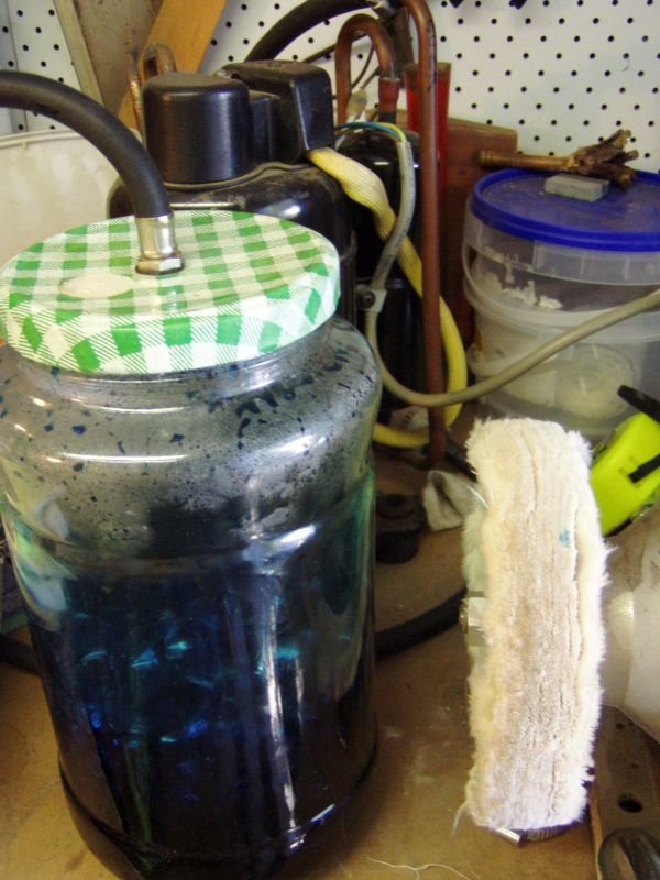

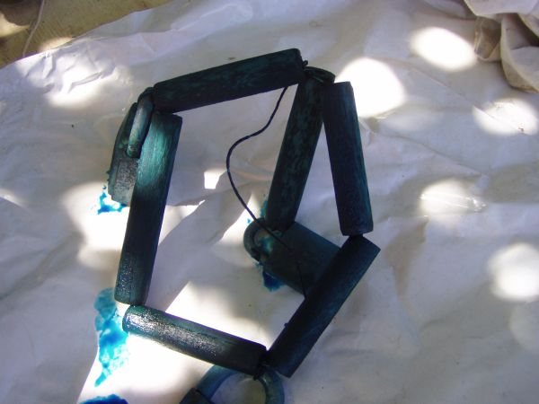

I did vacuum and pressurized and din't see any difference, Here is what I done for this pen
I have a large amount of wood from my son’s school,a commemorative tree fell down by strong wind last march, school colour is blue and yellow, I want to try to dye some green wood in blue and yellow, I bought water base blue and yellow dye from my local woodwork shop.
First I drill a 1/4" hole ( size of the mandrel )and turn the blanks, the bushing used is from the top barrel baron kit but I turn around the bushing to use the wide diameter then pass trough the whole a wire to tie them down with sinkers, did my dye in an old pot add my blanks and boiled them for 20 minutes, after when the dye was lukewarm I transfer the lot into the vacuum jar ( or pressure pot )after the process I left the blanks over night, take them out the next morning and let them dry here's some photos
Sorry lots photos for the yellow but is the same procedure
