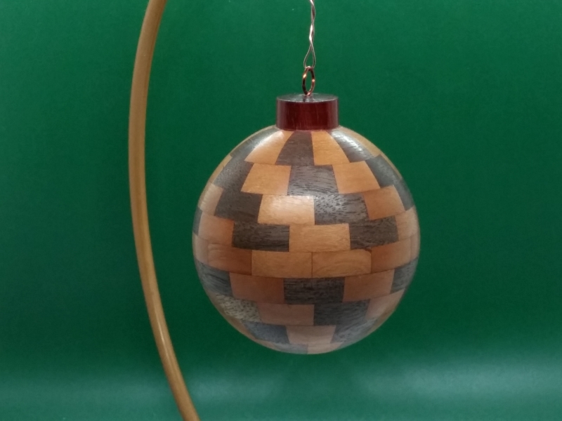

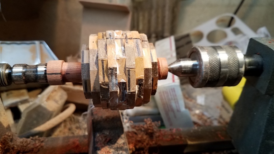

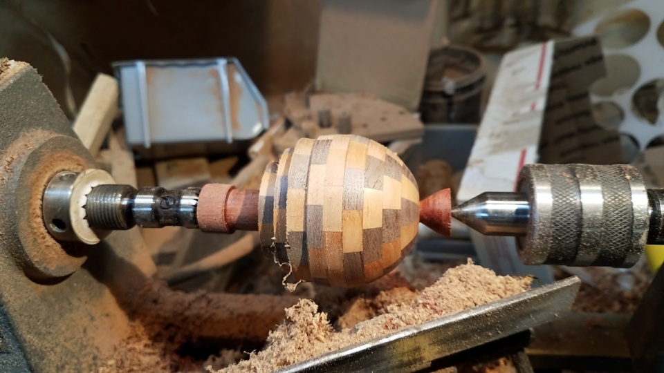

For Xmas I want to make segmented ornaments. I've started with just some cherry and walnut and i've come up with a way to make small segments (small wedgie sled), glue them up into small rings, get them machined into consistent thickness (router jig), glued together, and turn them into balls.
So now thinking I want to make some of the pieces in red and green and by using the multiple ways to cut and assemble rings should be able to make some cool stuff.
