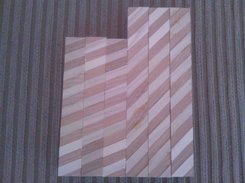

So I made a few blanks today from scrap cherry and poplar. Later this week I will be turning and dyeing them. I think I'll try food color dye first just to see how well it works. Thanks for the input, here's a peek at the blanks.
The secret is to turn first and dye later. Soakng the blanks in dye first will give you uneven penetration and no controll of final color unless put under pressure. Also uses less dye when done before finishing. Lightly sand any raised grain and wipe clean before adding CA or any other finish. Jim S
Many woods have a yellowing affect on dyes. Stick with white woods such as poplar, birch, box elder and maple. Those are the primary varieties on the market. Veneer packets are available on line. Cousineau Woods offers 1/16th birch veneer in a variety of colors. Great for segmenting. Soaking is inadequate for dying wood of any thickness. Dye after turning. Dyes tend to be translucent so repeated applications will not deepen the color. You have to strengthen the solution.
