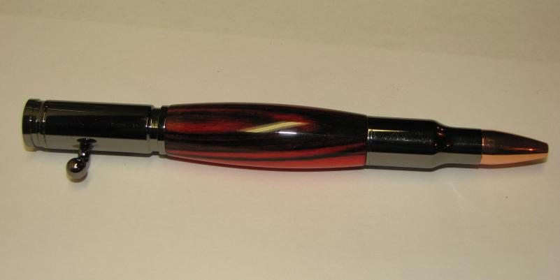

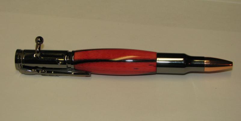

I got an order for a magnum bolt action pen, and the customer wondered if it was possible to dye zebrawood red because he wanted a red & black pen. I tried food coloring, and here are the results...
Gunmetal Bolt Action with Red Dyed Zebrawood

Thanks for all your comments, guys!
Chris, what was your process for using the food dye and how much?
I tried rubbing the food coloring on with a paper towel, but I ended up leaving the turned blank in a mixture of food coloring and water overnight because it wasn't getting very dark. I don't think it made much of a difference in color, though. I don't think zebrawood is a very good wood to dye, either. It's almost too dense.

Nice work on the dye job. It sure changed the appearance of that zebra wood. Made a very nice looking pen.
