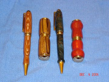

Well Jen, I have dyed a few blanks. I have used the Sharpie method and also used some of the Chestnut spirit dyes from Craft Supplies. Mixed results with both. I believe it has a lot to do with the type of wood being dyed. Also believe it has something to do with what you are expecting to see. As far as not getting much response, I did a post once looking to see if someone knew how to disassemble a particular pen and never got an answer of any kind and it was viewed 102 times. I would tell you to try some dying on your own and be your own judge. If you look at my photos there is a violet maple burl that I dyed. It was dyed when I bought it, but the dye had not penetrated very well, so I re-dyed it with the Chestnut spirit dyes mixing red and blue.

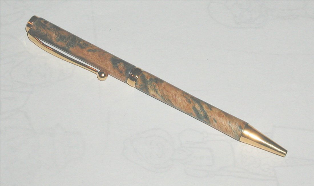

I purchased two dyed Maple Burl blanks from woodcraft, one blue and one dark red. The blue penetrated fully and made a dark pen, the red barely penetrated at all, leaving a gorgeous pen looking like Marble. So, even the pros get mixed results. Good Luck!

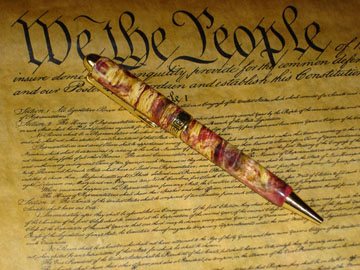

I have used Solar Lux by Behlen, to dye some blanks. I did this for a wedding pen sample. (would you believe they chose a blue corian over this!) I have done an American double twist with it as well. I turn to about 1/16" over size and then dip in dye once or twice and let dry, then turned. Wood is maple burl
