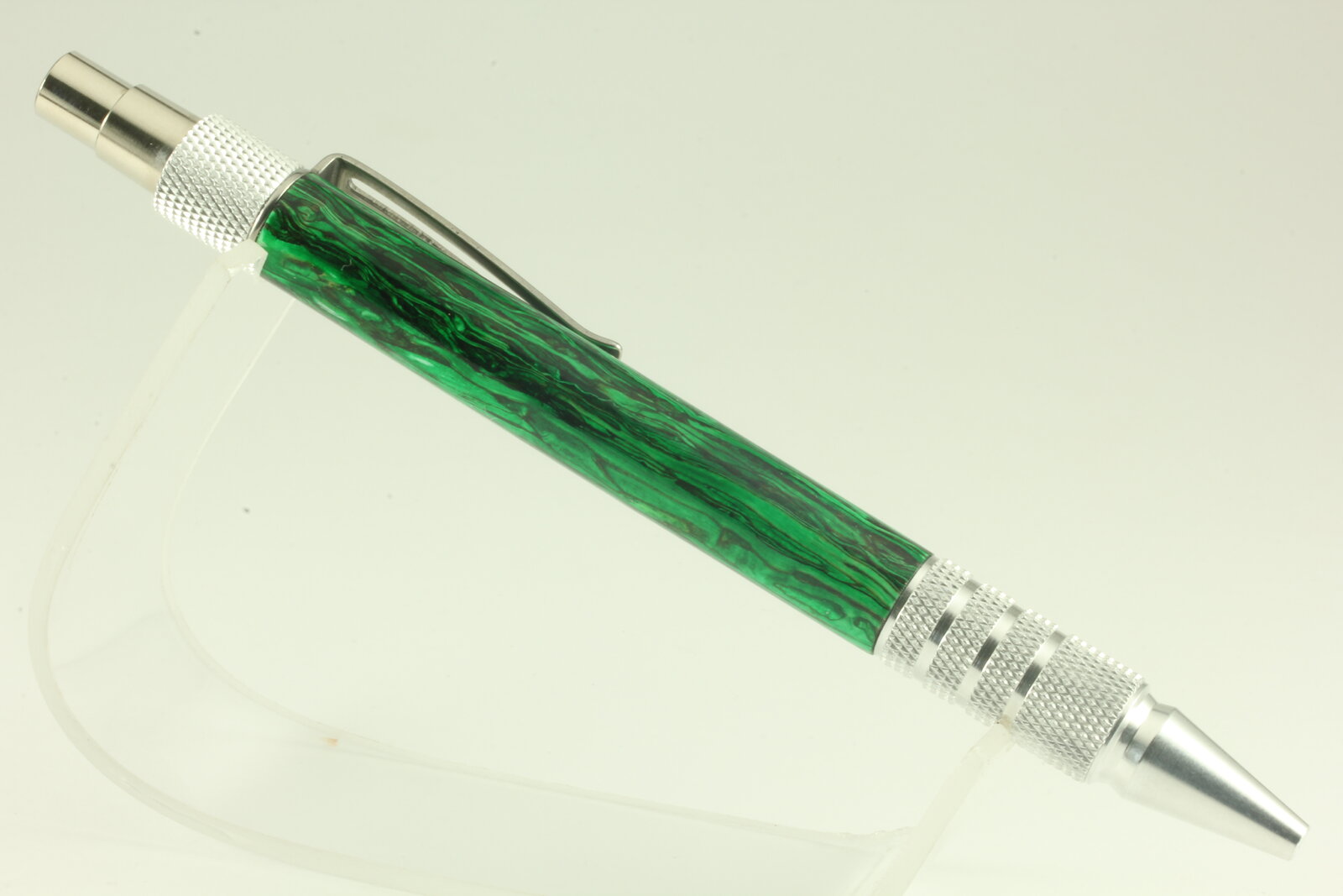

I am not as sophisticated as JohnU. I took some food coloring and used a paper towel. Got acceptable
results:

I am not as sophisticated as JohnU. I took some food coloring and used a paper towel. Got acceptableView attachment 311533 results:
Carl, that's beautiful! I have a block staring me in the face. I need to cuts some blanks off. I am intrigued, maybe a more natural color - brown, tan, but hey, the worst I can do is a splattered blank - been there, done that, will visit again! Thanks for the inspiration.
