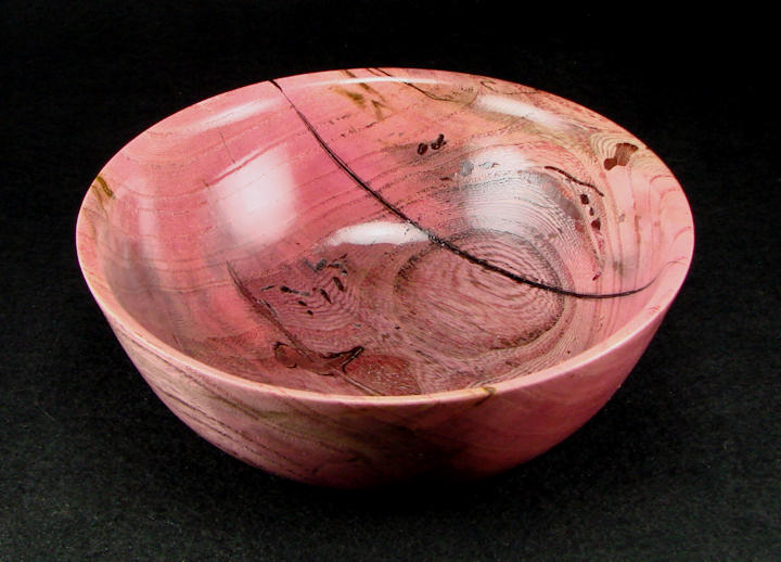

Here is one last pic for the night, I promise!
This was a test to see if I could get the stabilzing resin to penetrate a bowl blank. The blank started out as a 7.25" x 7.25" x 3.5" piece of spalted hackberry. It was not punky. I used burgundy colored dye so I could see how well the resin penetrated. I was doubtful it would go all the way through but was pleasantly surprised!
The black line was a save! There was a pretty large crack that the stabilizin resin filled somewhat but when I went to turn it, it blew apart while hollowing. I simply picked up the piece and used black epoxy to glue it back on and finished the turning.
Nothing fancy, just a basic bowl with a lacquer finish.

Curtis, great looking bowl, great save I think the line adds some character. You have posted some very good looking pens also. Glad to see you making time to do some turning.

Nice looking bowl. Looks like you are having a good time turning. It has been a while since I have seen your work posted. Good for you, glad you are having a good time.
