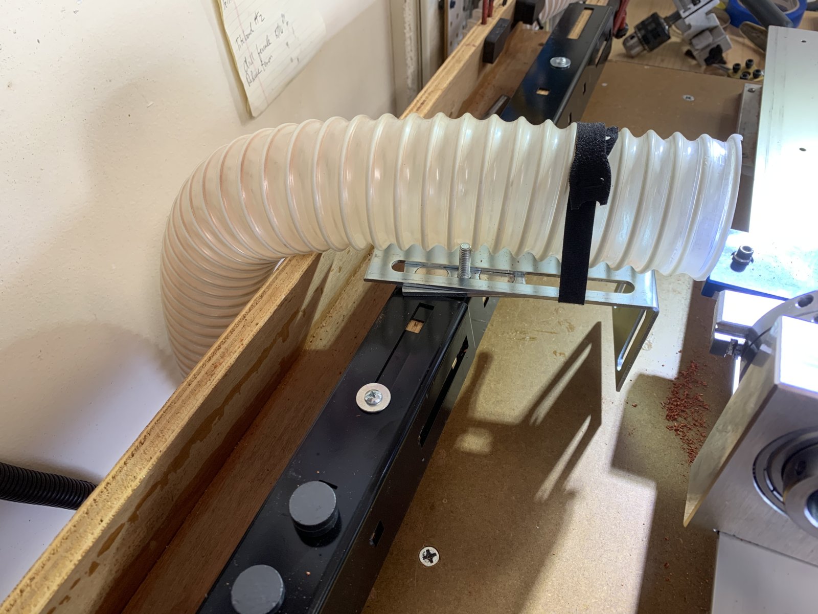

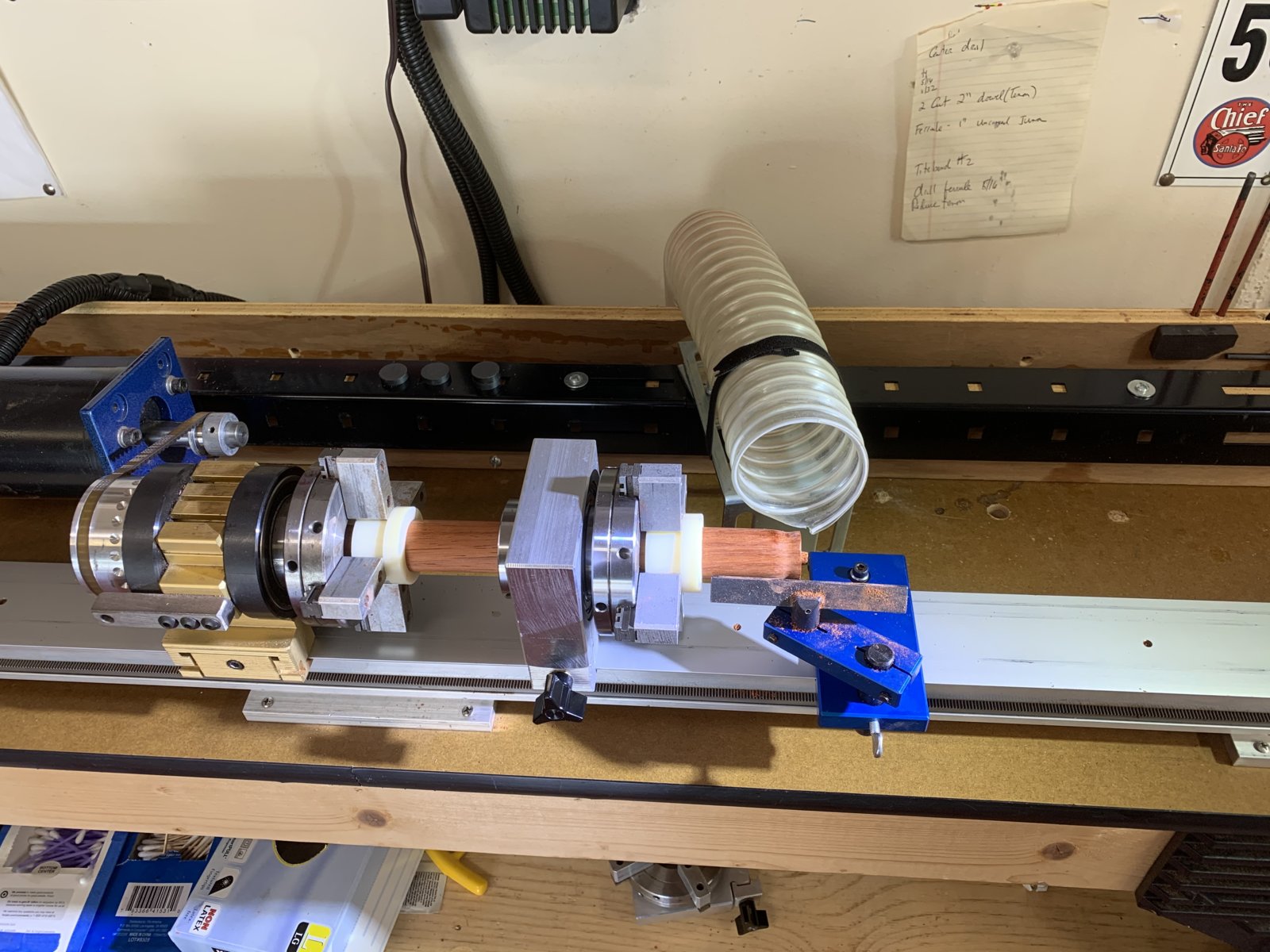

This is a start ... just need the hood. Magnetic attachment is perfect here. I started to order from Woodcraft but shipping is 10 for a $20 item. Need to add items.

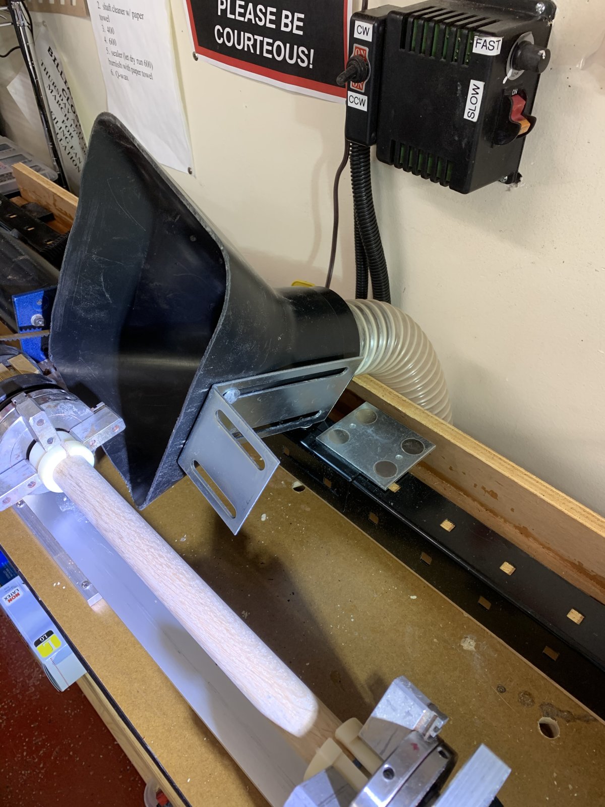

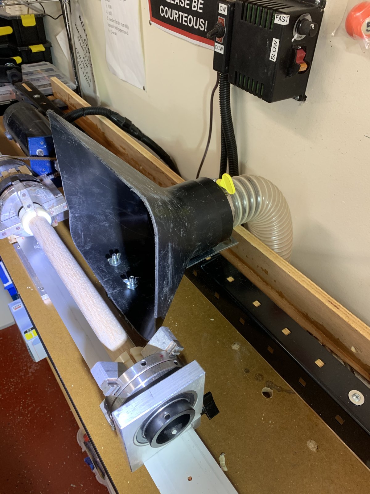

I trimmed a BigGulp... a little more contouring and good to go. Thanks once again for everyone's input.
