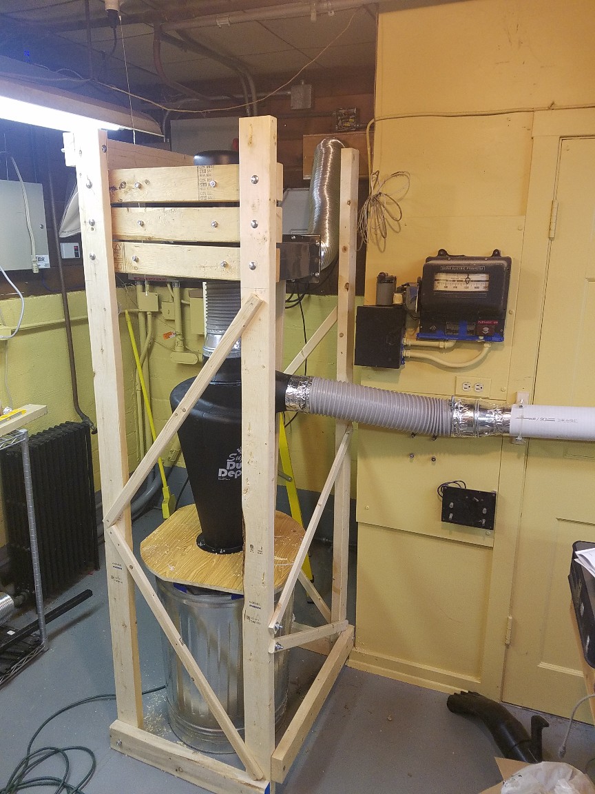

I've had an HF\Dust Deputy combo going for over a year now and no regrets. I put a wireless remote on it a few months ago and that's the only real change since install. It's inside my big work room, and it's loud, but not so loud as to bother me. Dirty air exhausts outside.
