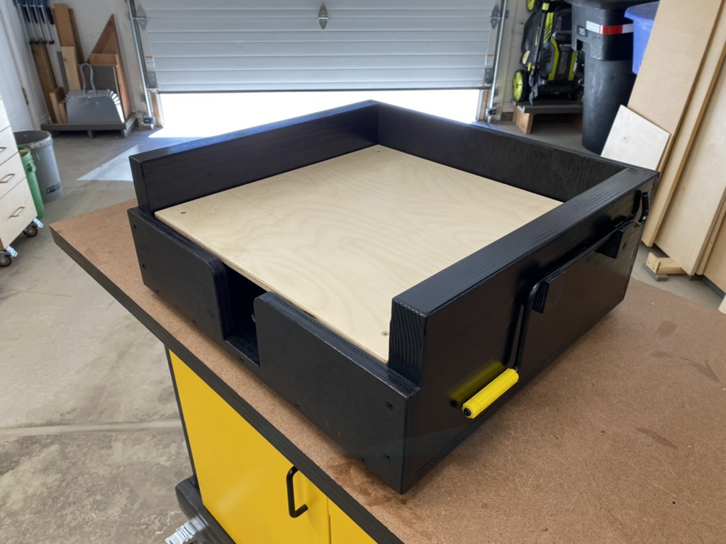

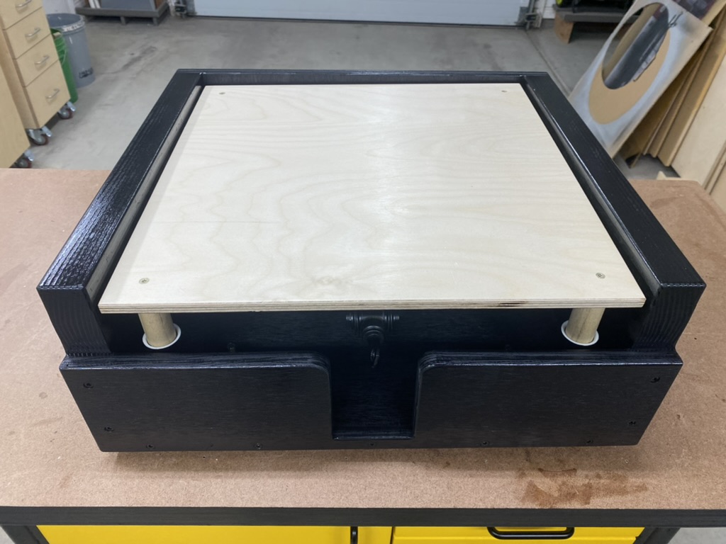

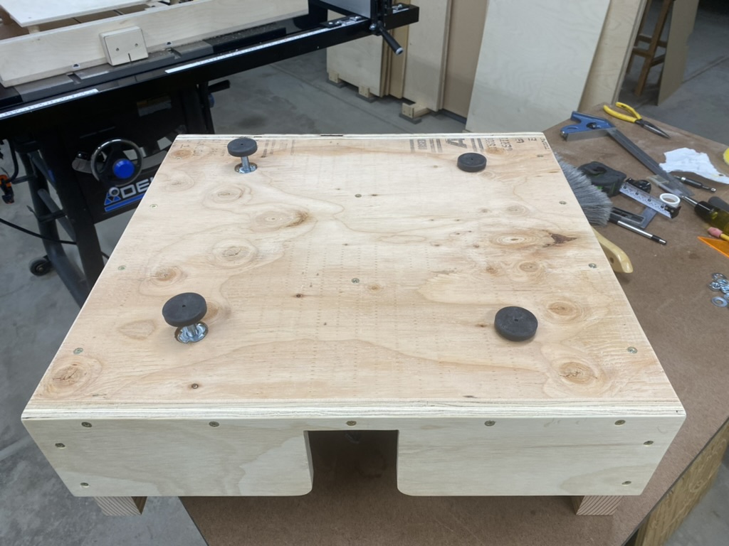

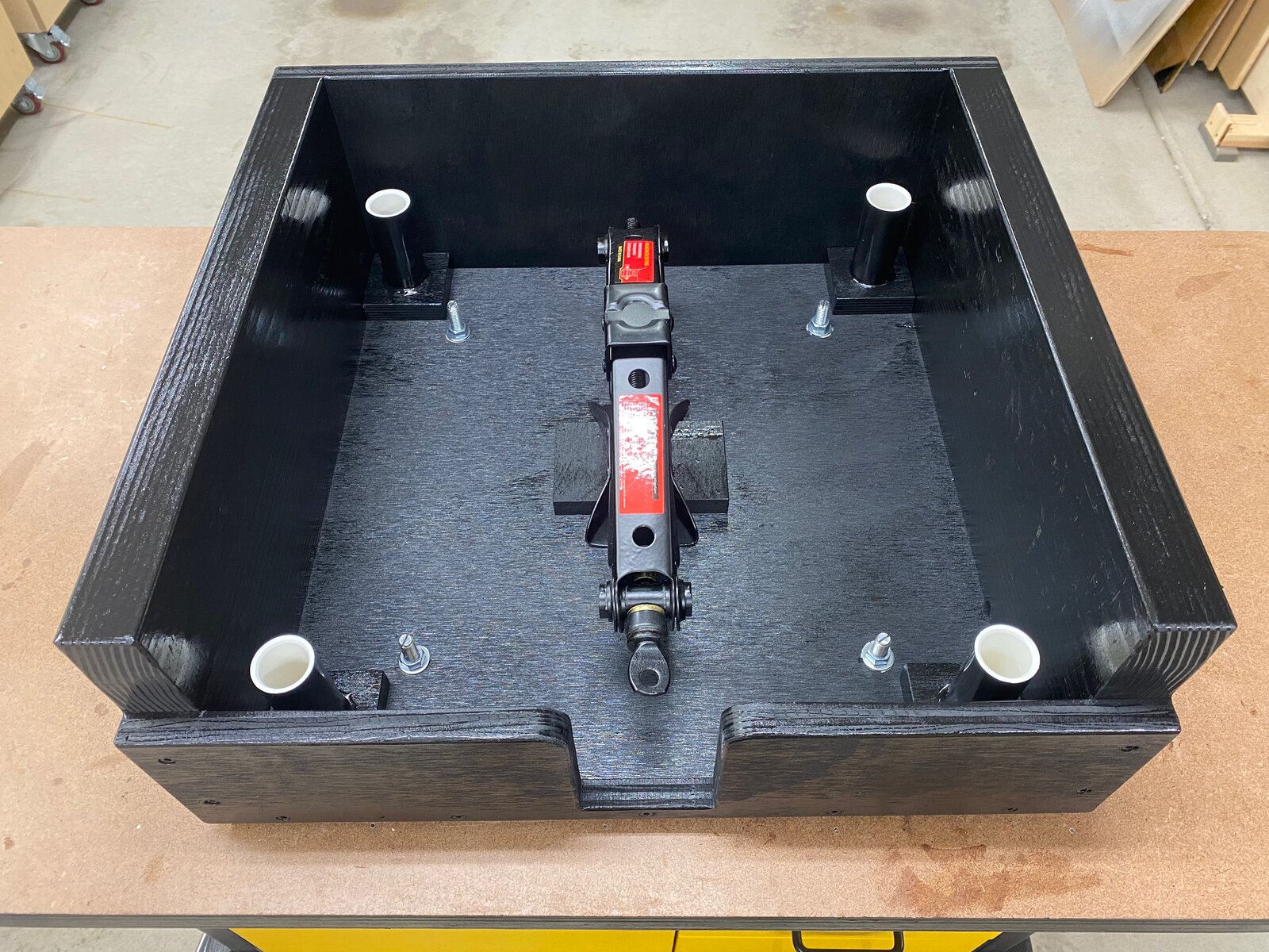

Here is what I did for the lift under the 30 gallon drum I used under my Super DD. Works like a champ!!
It uses a simple and inexpensive scissor type jack. I put PVC Pipe in the corners of the base with dowels down from the platform to keep everything aligned. T-Nuts into the bottom with feet allow for leveling it properly under the drum.
David - that is a pretty nice setup! I was thinking of some kind of a cam arm that would lift it, but the jack looks sweet. Not sure if I have that much space but if I do, would consider it. I think the pipe and dowel setup to keep it straight will be something I definitely will adopt because I left the lock ring on the drum and alignment is key to get it closed.
