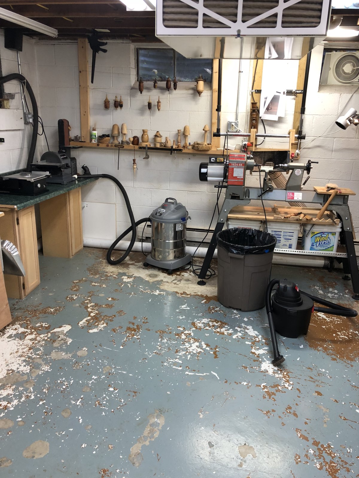

But, I believe the right sided picture of the three speed air cleaner is the exact one I use. I'll simply say I'd buy it again. I do not turn a lot. When I do turn, it is usually small segmented projects. I do use 5-6x/year a very messy hand router attached to a metal lathe skeleton when I cut slotted blanks (30-40 at a time). It creates a lot of small air particles. With this minimal turning, I can easily change the exterior filter in the unit 4x/year. That is air particles that I would be breathing... air particles that would be wafting upstairs into our kitchen... wafting towards my patient, but not naive "Wifey." (She's got a good nose; after sinus surgery for allergies a few years ago my sniffer is not so good). I will suggest you explore a more robust duct collector, but won't hesitate on the air cleaner.
Side Note: I have positioned the overhead air cleaner outflow to be directed at the intake of my dust collector port behind my lathe (a plastic household airflow vent diverter). Just a nice way to give some extra direction to chips, dust and fumes.
