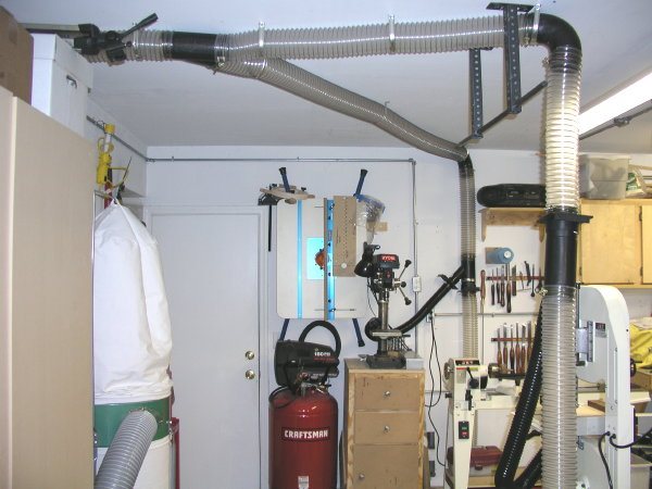

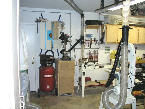

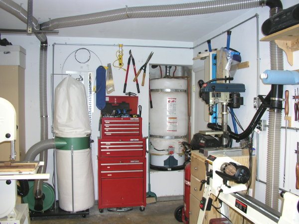

As of late, I haven't had too much time for pens. I was able to find a new home for my new lathe (Jet 1236) and get my dust collection routed. I ended up going with the 4" flex hose which I know is not the best, but actually works quite well with the short runs that I have. I still need to get some better bags to knowck the particle size down to about 1 micron since I can't have the collection unit outside the shop. The bottom line is that it has some strong suction. My band saw emits almost nothing at the unit. The lathe still needs some sort of intake, but even with the bare 4" hose it works well. I am heading to the plastic shop on wednesday to get some plastic for a custom idea I have.

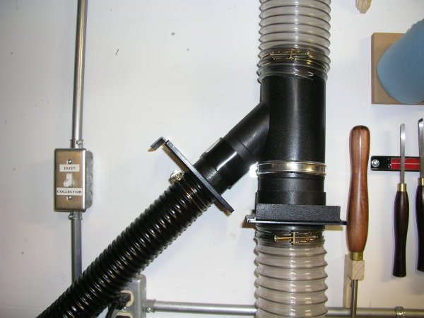

I ran a dedicated 20 amp line to the DC with a spare wire for later upgrade to 240. I installed a 20 amp toggle to turn on the DC from a central location near the lathe. I was going to go with the remote, but this worked out better for me (and was only 3 bucks instead of 60).

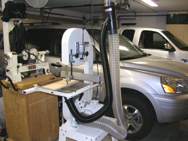

The band saw has a 4" that gets reduced to a 2" at the body back (Jet should have made this a 4"). The black hose is 2.5" and cathes the dust from the bottom of the table. The two hoses are controlled by a single blast gate.

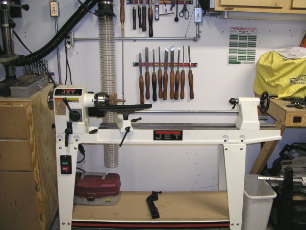

My new Jet lathe.
This point goes to the lathe (4" clear) and to the Drill press (2.5" black). There are two blast gates here to control each port.

You'll love the 1236...mine is quite problem free since I bought it 2.5 years ago. Only thing that happened is that burr inside the MT2 driver...which is probably caused by an operator error [:D]

Great looking shop, I actually like the switch for the DC idea. it would prevent me from flipping off the collector every other minute which is not good for it. directions with mine said that if it will not be shut off for 10 to 15 minutes then just leave it running. Did the band saw come withthe upper dust collection hook up? I want to do somethign like that on my Grizzly but don't have a connection there. I already have my hoses split like you do though.

Unfortunately there is not dust port at the 2nd (2.5") location. Really if you get the hose next to where the blade passes through the table, at the roller bearing, it does quite well. I have been cutting flooring all day on both the Table saw (outside) and the band saw. I am almost done, but there really isn't any dust laying aroudn to speak of. Before, the cars and shop would have been burried.
As for the switch, your shop is going to be a nice size. The switch thing is still a great idea. They make a simple 20 AMP series swithc that will allow you to control the DC from multiple locations. You could mount 2 without issue in good central spots to various tools.
