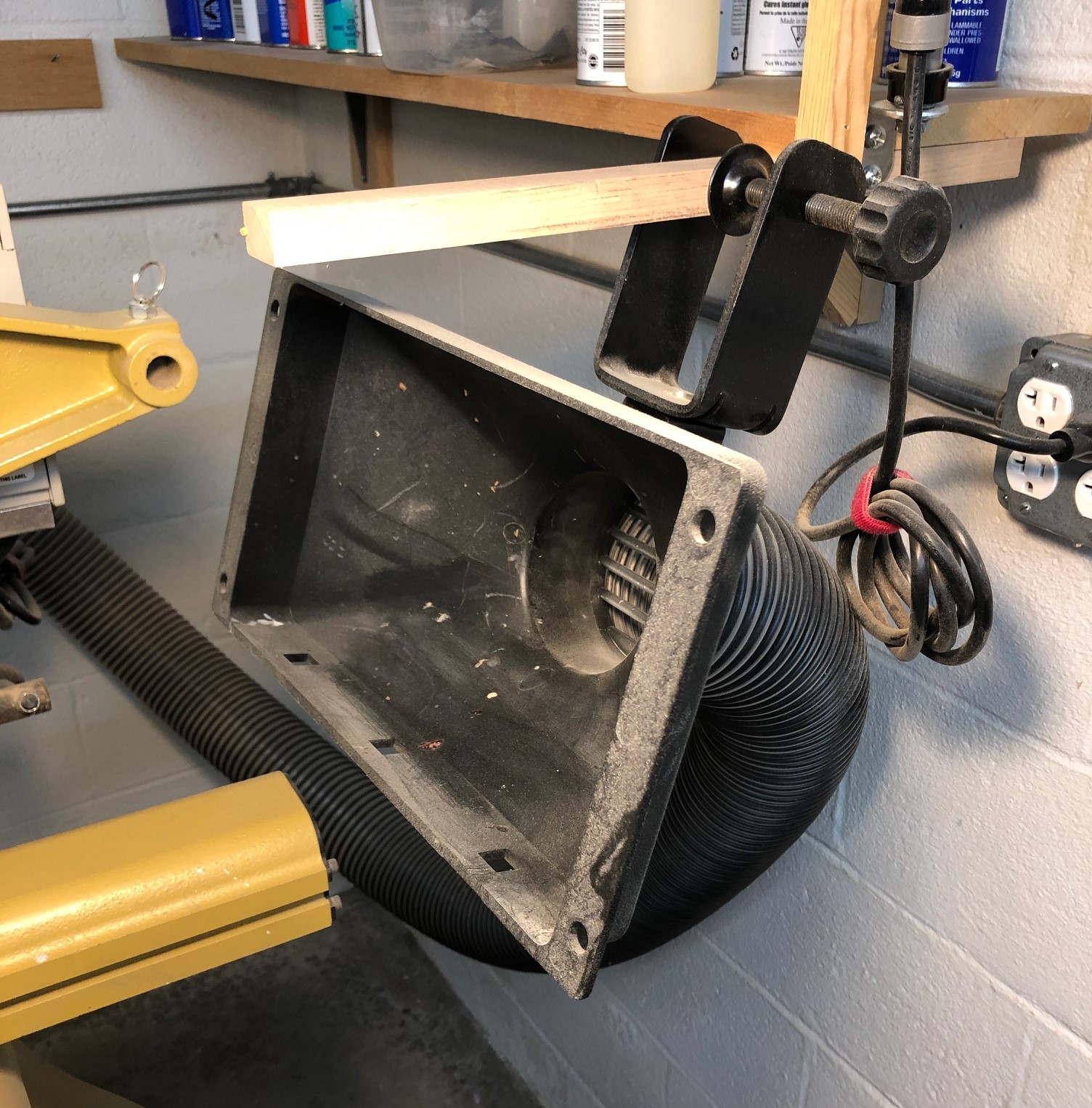

I use a hood, mounted behind the lathe, connected to my central collection system. It has a clamp so I can easily reposition it where I need. Not sure where I got the hood - I think it's intended for a router table or other enclosure because it has mounting holes. Connects to a 4" hose.

I use something similar to what Jeff has. When I lived overseas, I started with something simple as he showed, and when I moved back home, I installed something similar. Mine is a bit closer, but still behind the lathe. It isn't complicated but does take a tiny bit of ingenuity. Adjustable helps.
OH, I see that Jeff's is adjustable forwards and back by the use of a clamp.

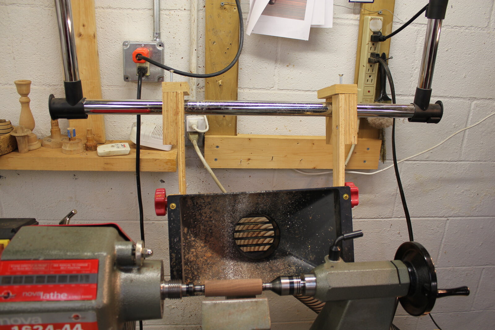

Here's another photo to give more options. The brackets were a cloths rack. Attached to the ceiling joists. The black inlet can be moved L-R and angled closer or further back. The back attachment can be modified to whatever diameter you are using.

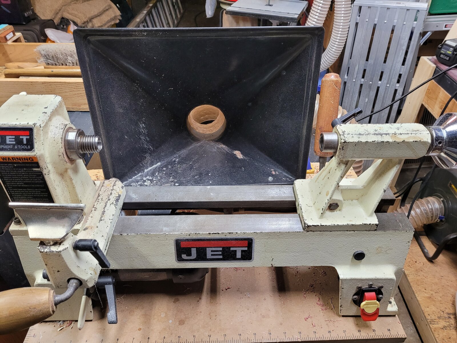

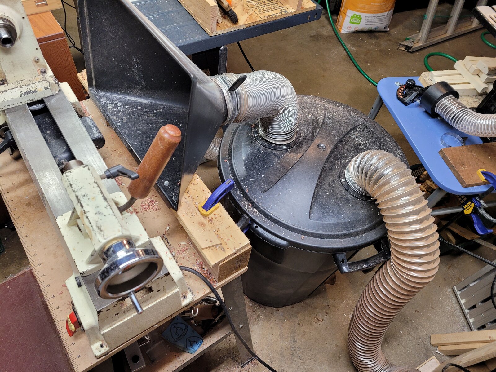

I bought a "big gulp" dust hood, originally intending to make something for the contractor style table saw I have, but ended up using it behind the lathe instead. I screwed it onto a board and just clamped the board to the stand. Don't mind the mess. The shop is a disaster. I just move the hoses to the table saw (I made something else for that), or the bandsaw when needed. The trash can catches the big chips and most of the dust.
