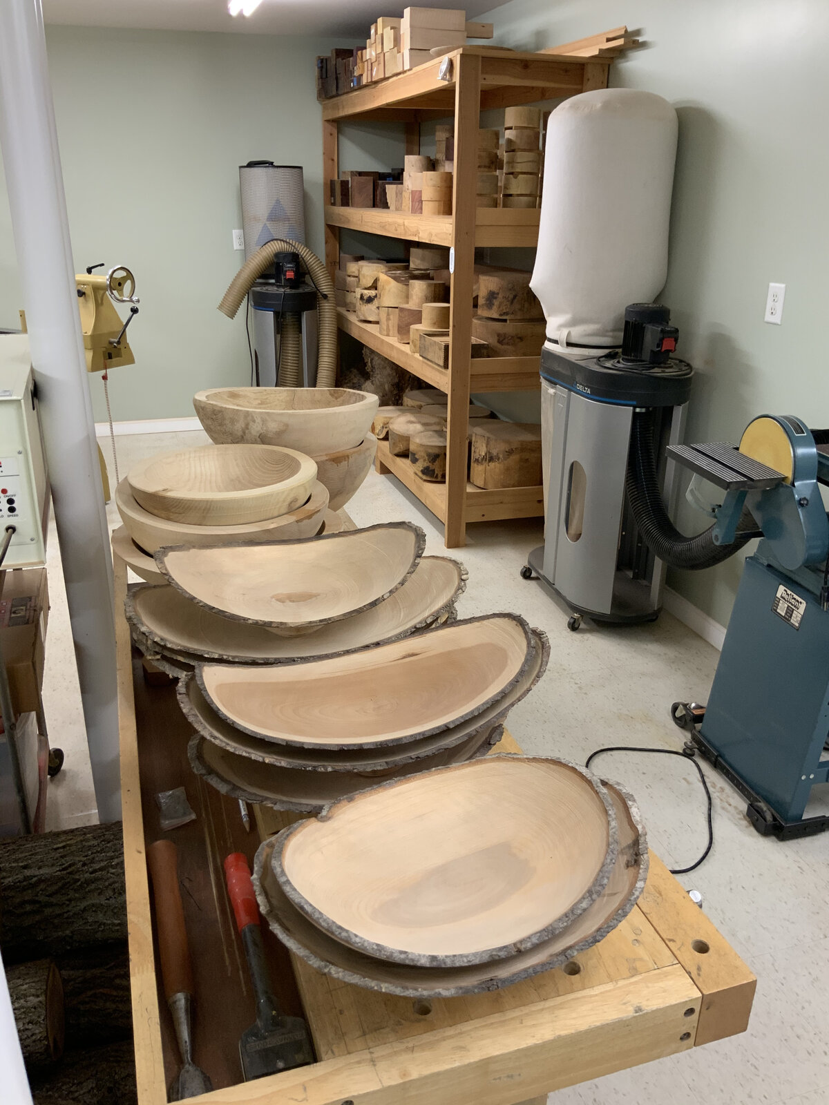

My advice would be to keep it simple and stick with your portable single stage. Use the money for a capability or tools you don't have. Been using the canister portable for the past ten years on the bandsaw, table saw and lathe sanding with excellent results. The bag unit stays with the sander because it's used for short durations frequently.
