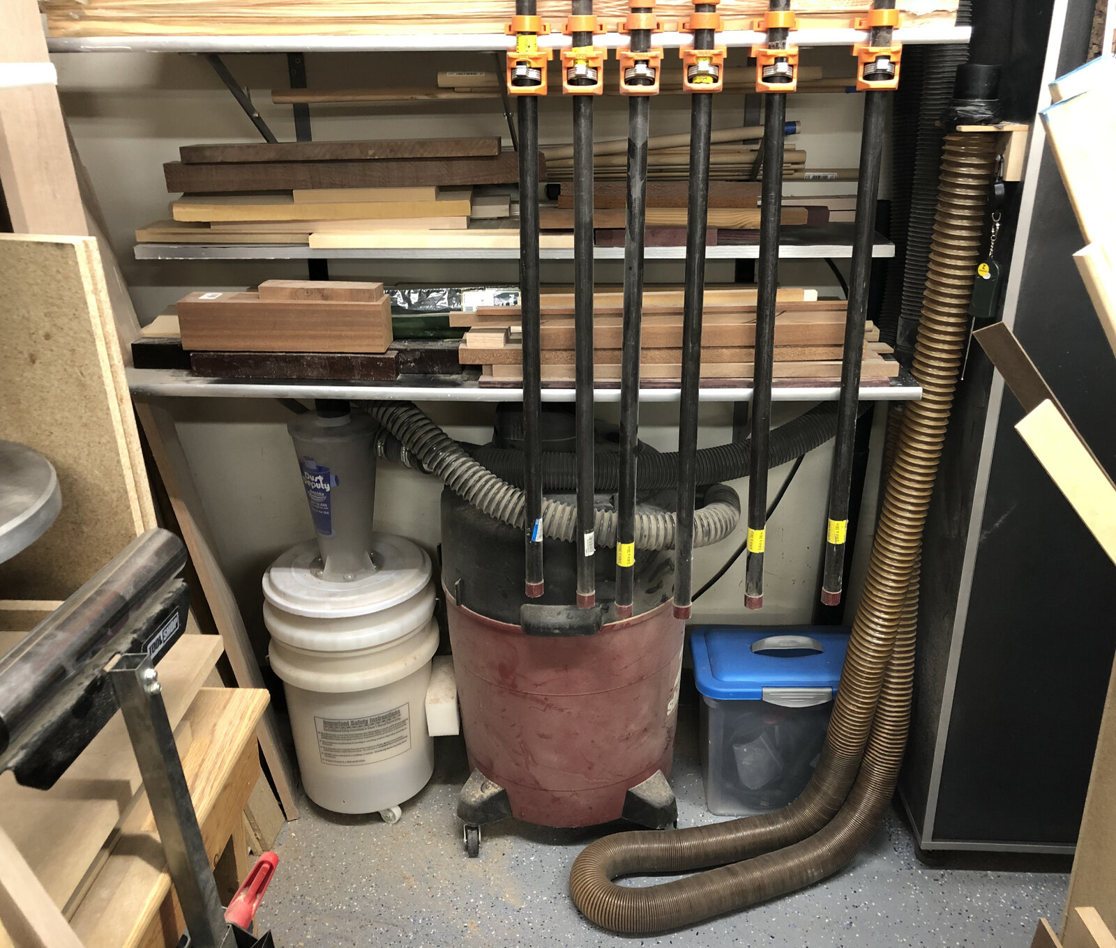

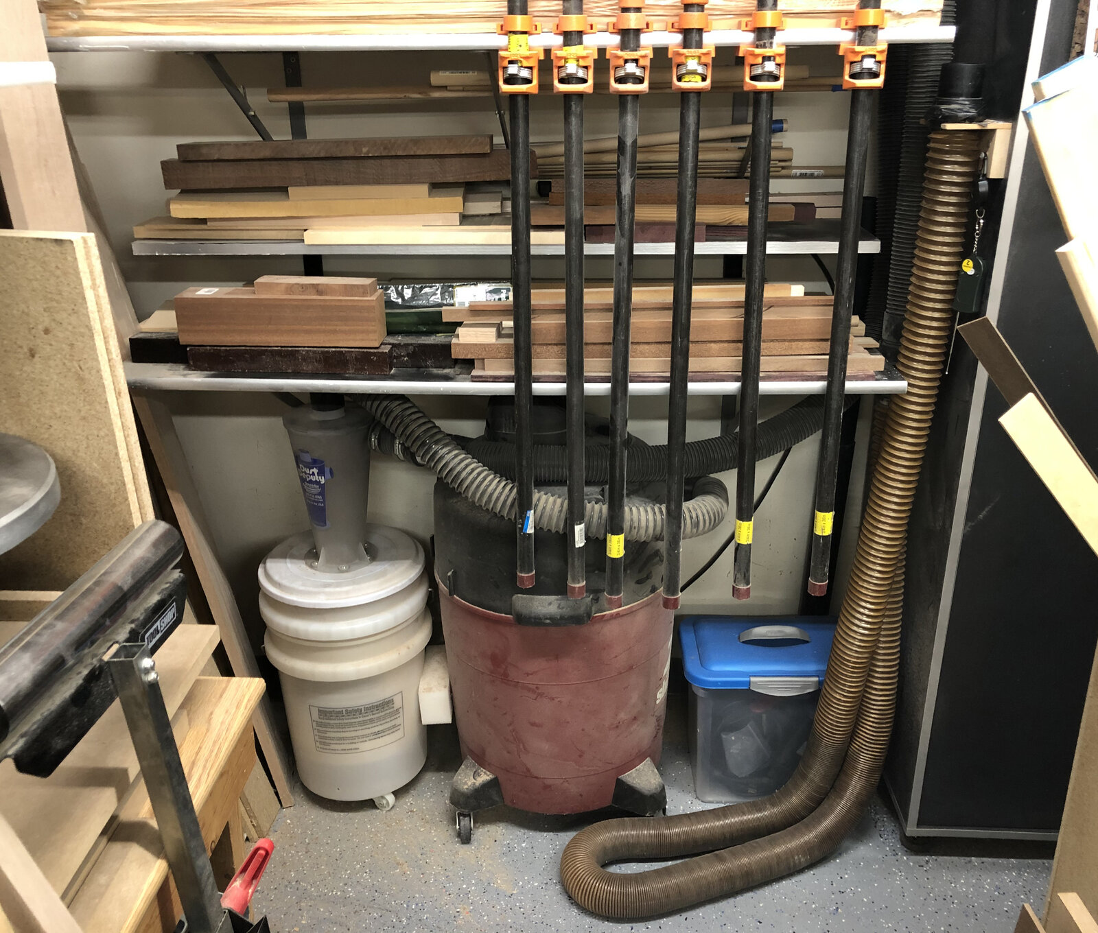

Greetings from Nebraska - First of all, I am in no way any kind of expert on dust collection systems; however, I do have a small basement shop with most of my tools (table saw, miter saw, planer, etc. all mounted on mobile stands so that I can roll them in and out of the center of the room when I need to use them.
For dust collection, I have been using (and am very happy with) the following. I have a big 25 gallon Shop Vac plugged into a remote on/off switch made for inductive loads. I have a Dust Deputy, two bucket cyclone separator (5 gallon plastic pails), the $100 model, connected to the Shop Vac which collects the dust and debris very well. I also have a drywall bag in the Shop Vac in case there are any fines that don't fall out in the cyclone. After more than 3 years I have never had to replace the filter bag and the Shop Vac continues to have plenty of suction.
Although the vacuum and Dust Deputy are both on wheels, I have them tucked under a shelf and only need to move them out when I need to dump the bucket. I have a Dust Right 2-1/2 Expandable Shop Hose (Rockler) connected to the Dust Deputy - it is a very stretchy hose that stretches from about 2-3 feet to 12 feet. I manually move the hose from tool to tool as necessary when I am working in the shop. Most of them had a 2-1/2 inch port anyway, but a couple (like my bandsaw) needed a 4 inch to 2-1/2 inch adapter. I also have a claw tool and regular floor tool that I hook to the hose to clean up any chips and over-spray from the various machines.
With hoses, adapters, fittings, the Shop Vac and the Dust Deputy, I have less than $500 tied up in the whole System. If I had the room, I would have loved to have a full size 4-inch system, and I am sure that a 4-inch true dust collection system would be much more efficient, but considering the limited space I have I am very happy with the compromise I made. The hardest part is maintaining the discipline to move the hose around and switch on the vacuum when I am only going to make a quick cut on something. There are lots of systems, options and ideas out there - I'm sure with patience and research you will find a system that is ideal for your small shop and situation.
