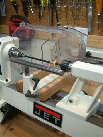

I normally turn the collection on only when I'm sanding. I clean up everything else when I'm all done. I've been using a hood that has a wood stand with magnets built from an article here.

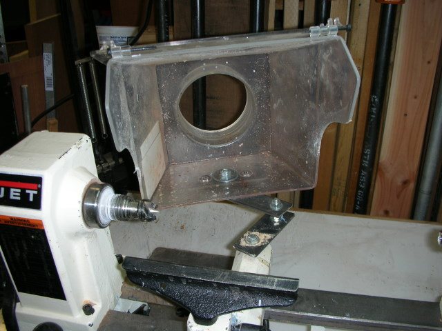

I use this little hood for collecting shavings and dust from my lathe. I found it in a harbor freight catalog, but I think you can get it from some of the other woodworking suppliers as well.
I made a little articulated arm out of some 1/4 inch bolts and flat steel that lets me position it close to the work.
I find that it collects maybe 75% or so of the shavings, which can help a lot. Where it really helps is with sanding, as it creates enough of a breeze to suck up all the sanding dust.
The little arm mount is nice, as it moves with the tool rest, if I'm working on larger than pen turnings.

Check out my article on the penturners.org main page on that very subject. It is held to the lathe by rare earth magnets.
http://www.penturners.org/content/DustHood1.pdf
