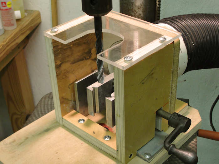

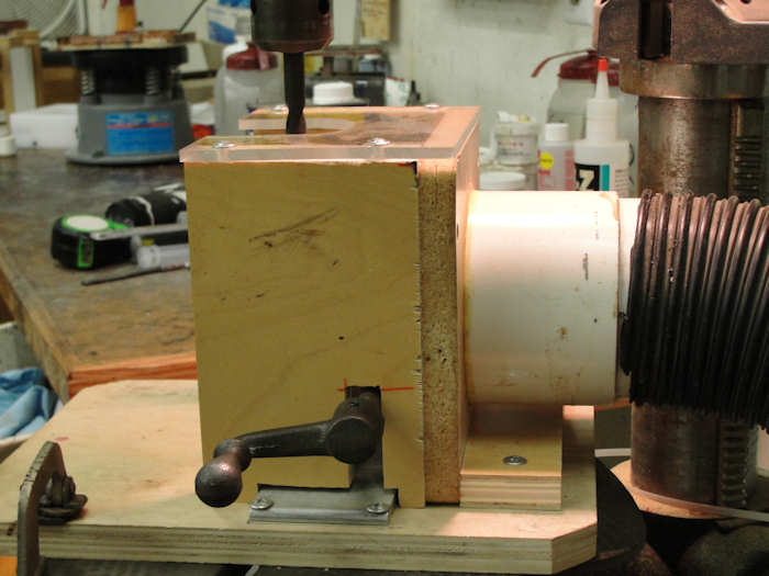

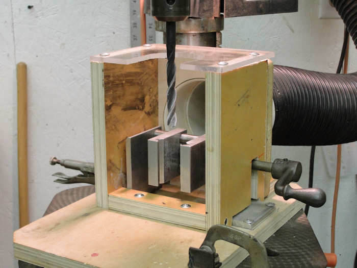

As a result, I sometimes get obsessed with dust collection! Here is a DC "hood" I came up with for drilling pen blanks on my Paul Huffman vise. It works FLAWLESSLY and not one tiny little flake escapes!
Here is a short youtube video I made to demonstrate how well it works. Beware, my video editing skills are SEVERLY lacking but you get the point anyway!

That is one friggin sweet little DC you got there sir. You got all the nice toys!

Curtis.. Wickedly cool (and the video is too).... For alot of my drilling, I attach the 4" hose near the back of what I'm drilling leading to the DC, but this does a MUCH better job than just the hose! Wow... Good ideas.

Nice job with that hood Curtis. You also managed to catch a very good demo of drilling a blank. very nice touch using clear plastic, it really shows the details of pecking and all.
I will have to go quite a bit larger to surround my vice but am sure I can get the same effect. The drill press is still one of the tools I get a lot of dust collecting around. I have the lathe and band saw pretty well under control. Not sure what I will do about the radial arm saw. i located it to close to the wall so i have to get massive creative on that one.
Wow Curtis, that's another great idea. I've been using one of those 2 1/2" hoses that will hold their shape. Not nearly as effective.
