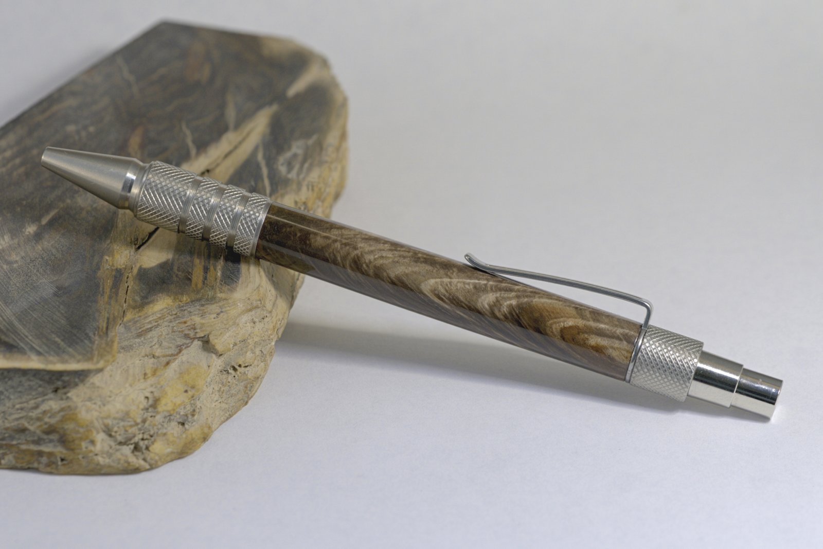

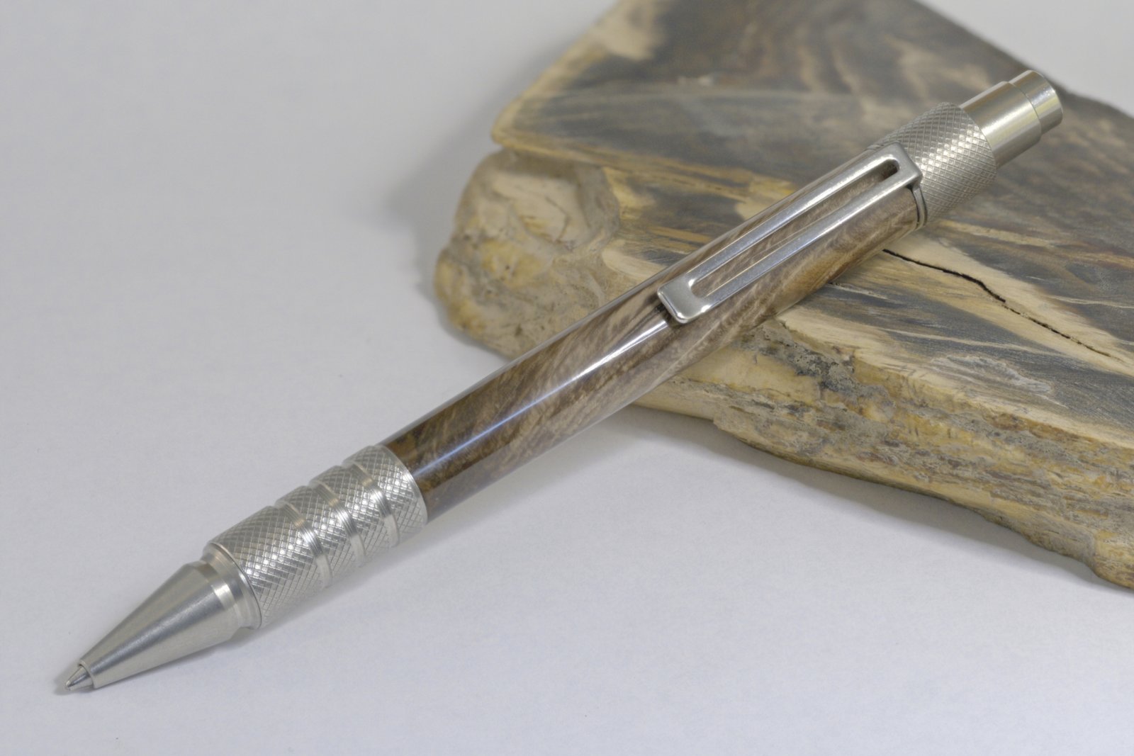

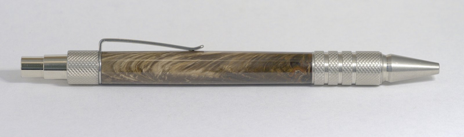

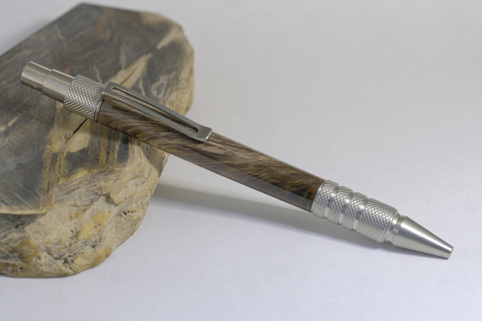

Absolutely amazing petrified wood.
Very hard . . . mohs 7.
Polishes up to a very nice gloss.
Thanks for looking!
