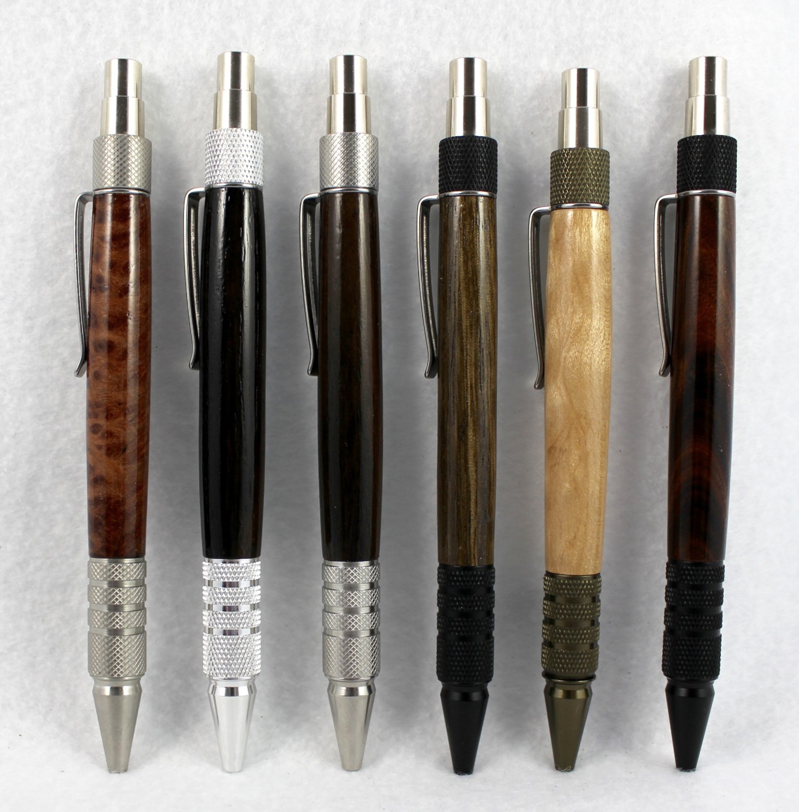

If you've turned the new Dura Click pen and have pictures let's see some of the examples. It seems to me that a fairly straight bushing to bushing profile is best but I'm always open to something different.

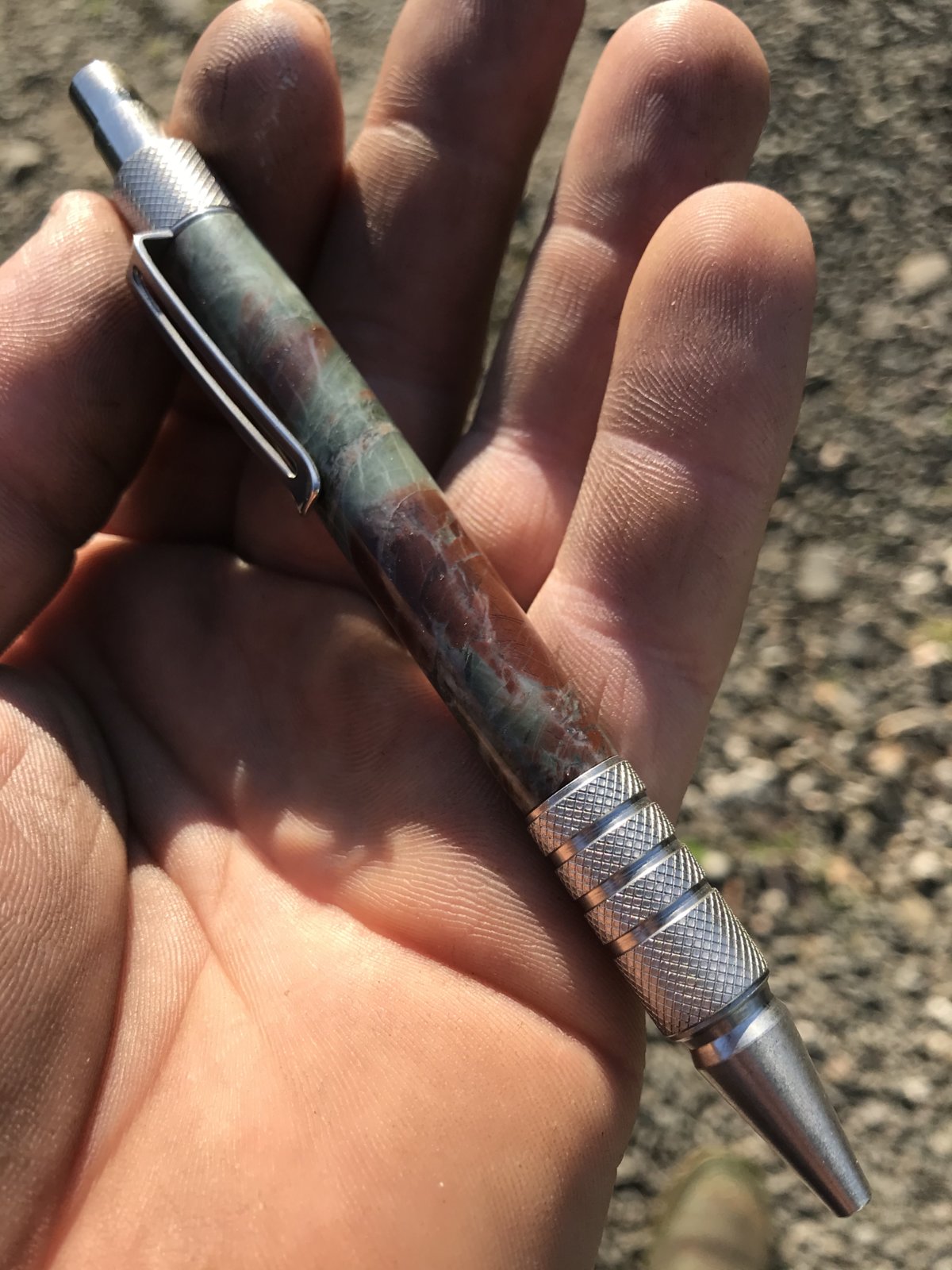

Might try a few more at reduced length. The clips have a nice tension. Some novelty pens need a crow bar to open the clip for shirt pocket carry.

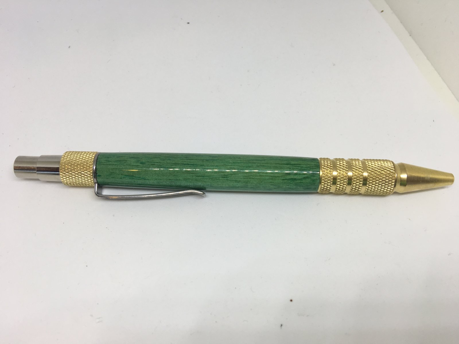

The EDC is a nice pen when shortened. I took a tad too much off and had to trim the refill. But the pen length is great. Will post pictures later.

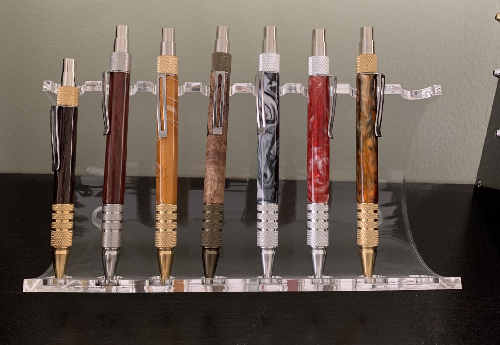

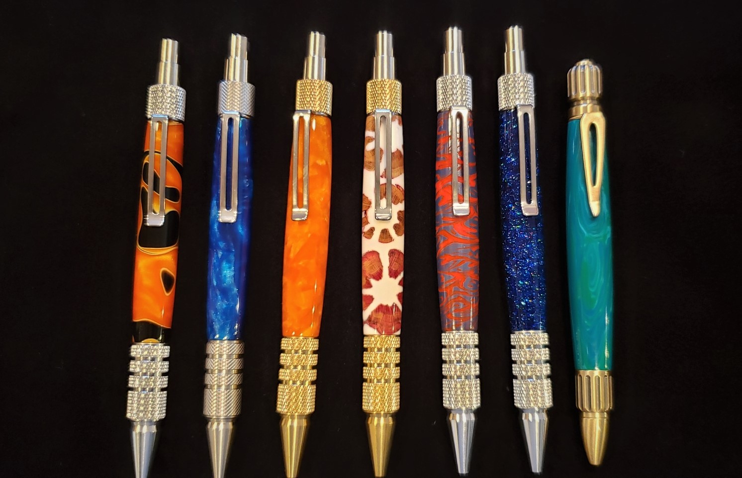

I have made a few more, but sold them or gave as gifts. Here are some from my inventory as well as my person EDC (the red and blue M3). I also made some ED classics (see the green one in TS).
Here's my collection of DuraClicks right now. I haven't really done anything but a very slight curve, almost straight.

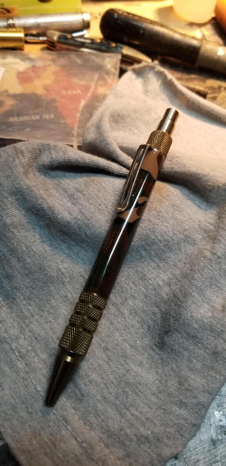

The latest one . . . not glued up yet. Just a dry fit.
I've had to trim the click mechanism a little . . . now I'm very careful taking off those last thousands, trying to get the blank end square.
