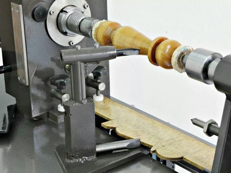

My wood lathe have build in attachments to do copy turning from sample and template
Copy turning with template
I do all my pen turning activites using this machine. It can also use for free style turning with the attachment

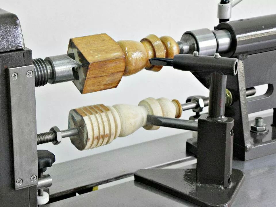

Interesting. Yes I would like to see it in use.

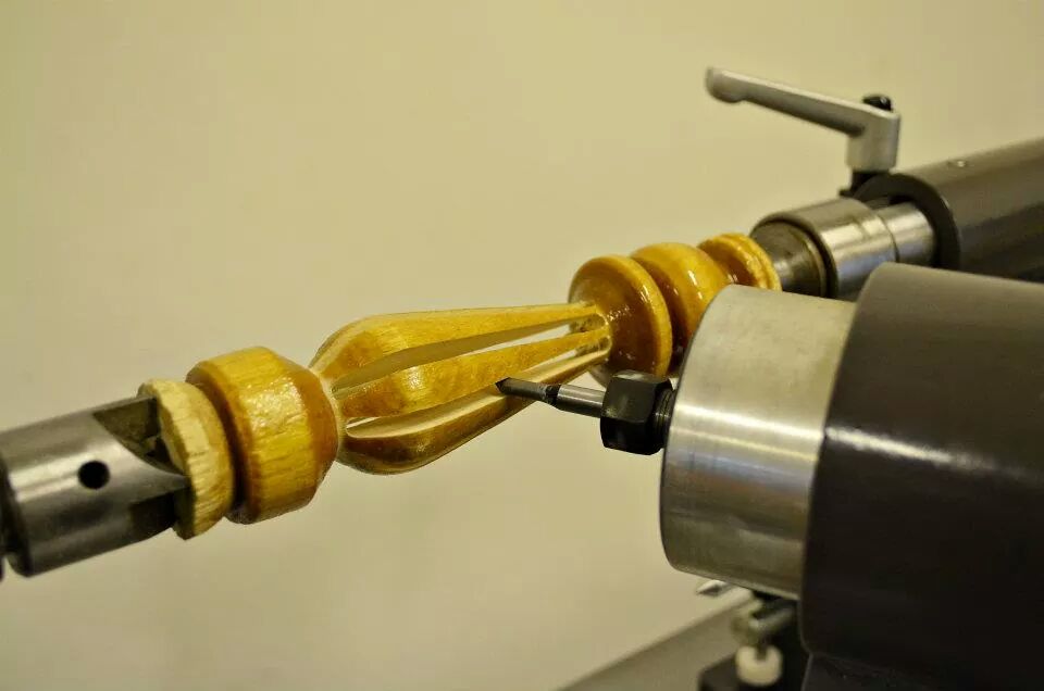

No problem, I will post tmr ( It is midnight here). Meanwhile, my machine in conjunction with a build in indexing can also carry out fluting process.
