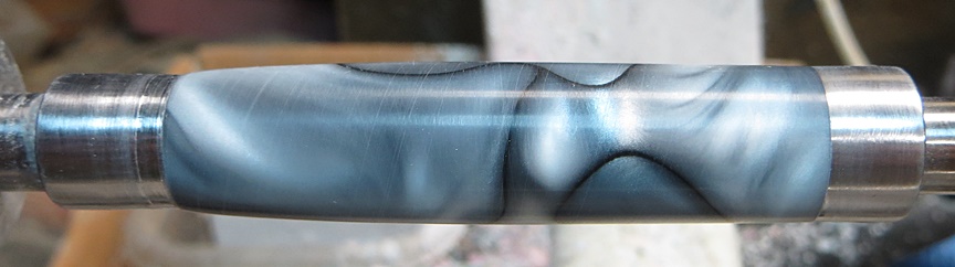

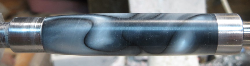

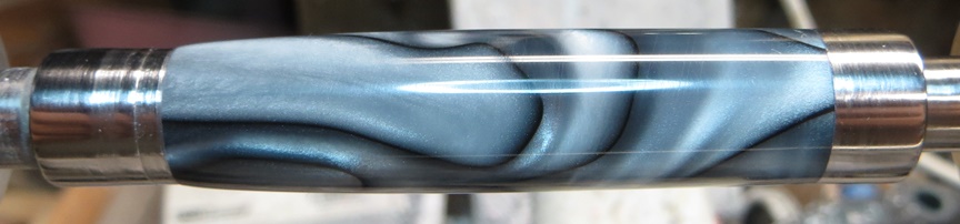

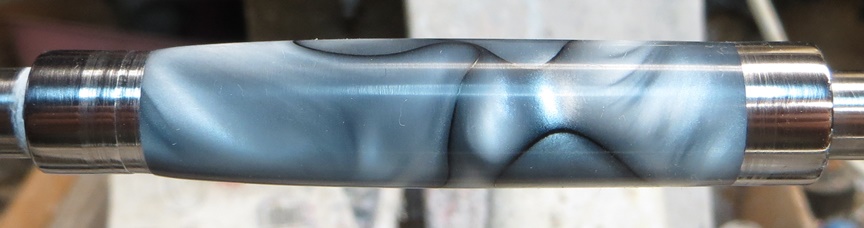

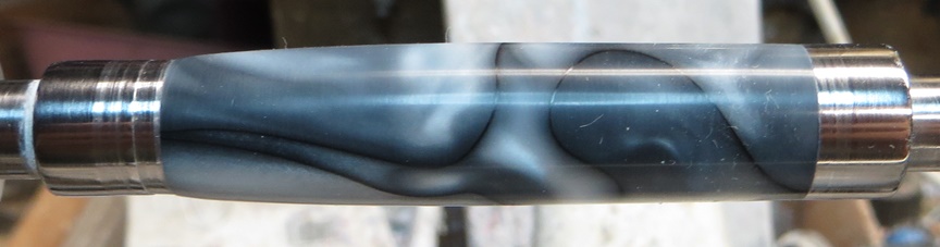

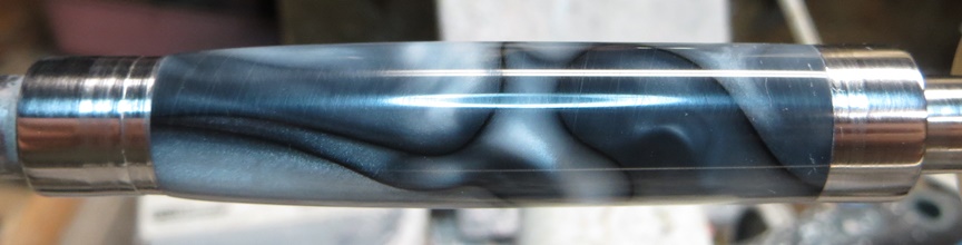

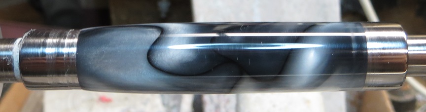

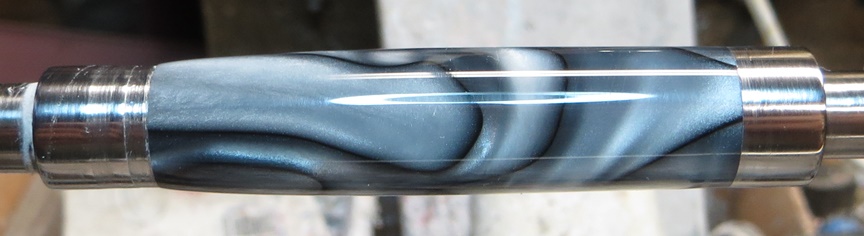

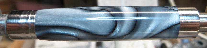

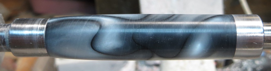

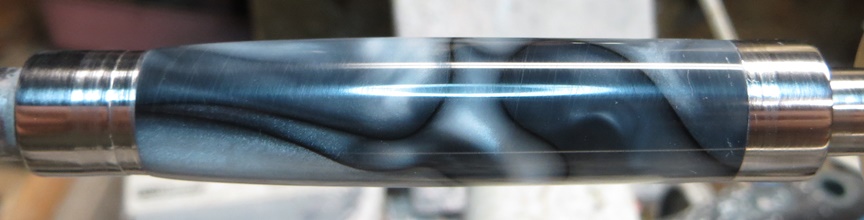

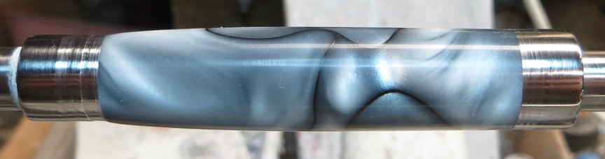

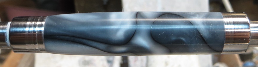

The first two pics are after wet sanding with 320 and 400 grit. The next two are after the first two grades of Micro Mesh. Then after all nine grades of MM. And the final two are after 0000 steel wool. I like how it turned out. Thanks guys for the suggestion.

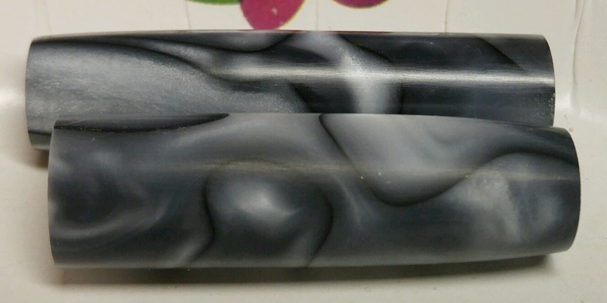

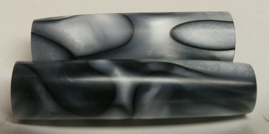

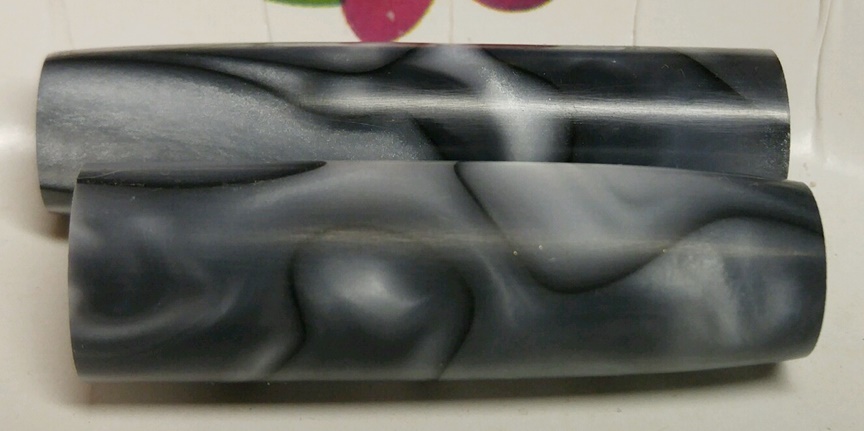

I got both bodies done. I used the steel wool both while the lathe was turning, and lengthwise with the lathe off. If you look at the photos close enough, you can barely see tiny scratches. But with my naked eyes, they look great. I'm well pleased.
