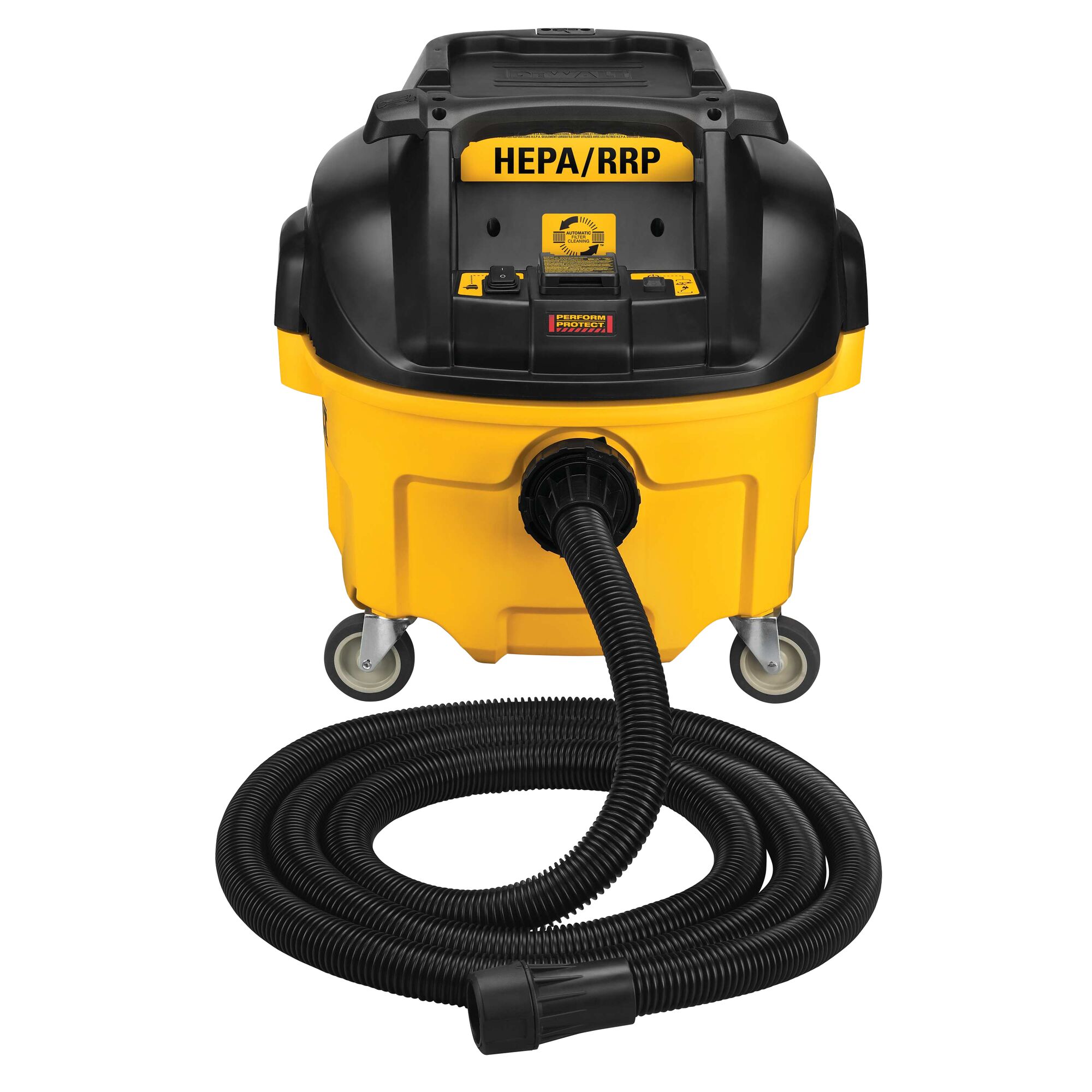

I want a small, powerful (inexpensive haha) unit for sanding drywall or using at lathe. Any opinions, experience with the 8 gal Dewalt? I would like a unit as small as possible...any other suggestions.
Something strange there. All the places I looked at the price is $400 but Lowes it is $300 and not in store. Alot of money for a shop vac. Automatic filter cleaning. Never seen this before.(of this type) Another thing to go wrong. If I am spending that kind of money on a shop vac it will be a Festool or even a Fein. A shop vac is designed to collect dust at a direct source thus the small hose. Why you mention sheet rock dust I have no idea but again designed to hook to a sanding tool. My opinion
