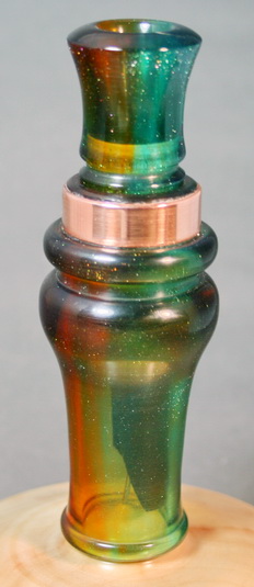

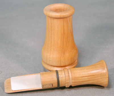

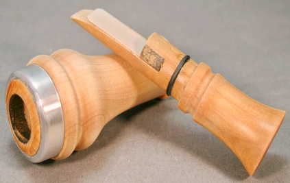

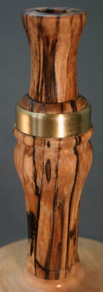

Here are a few calls I made. I cast the one made from Alumilite, after learning how to cast from this forum, and I stabilized the spalted maple call before I made a call out of it. I learned how to do that on this forum too!
Happy turning
Tom
