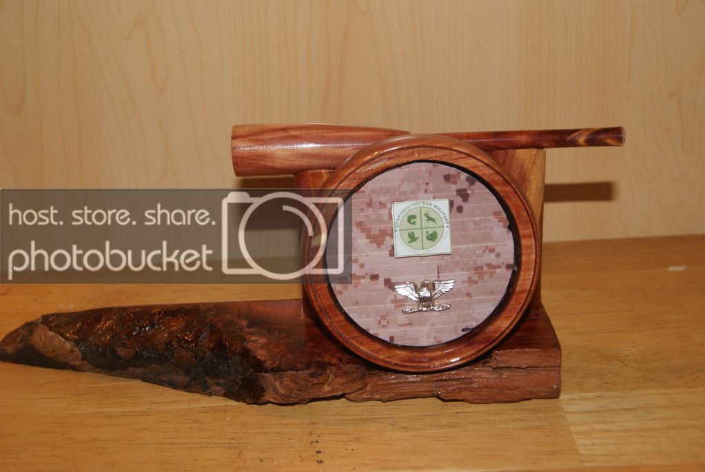

This is a call I just made for the retirement gift of the Quantico Base Commander. Its cedar, with a decal on the sound board, and a raised QIMSA Logo.
QIMSA is the Quantico Injured Sportsman Assoc, we bring wounded warriors down for free turkey, waterfowl and deer hunts. The CO did a LOT for us, so I made this for him.

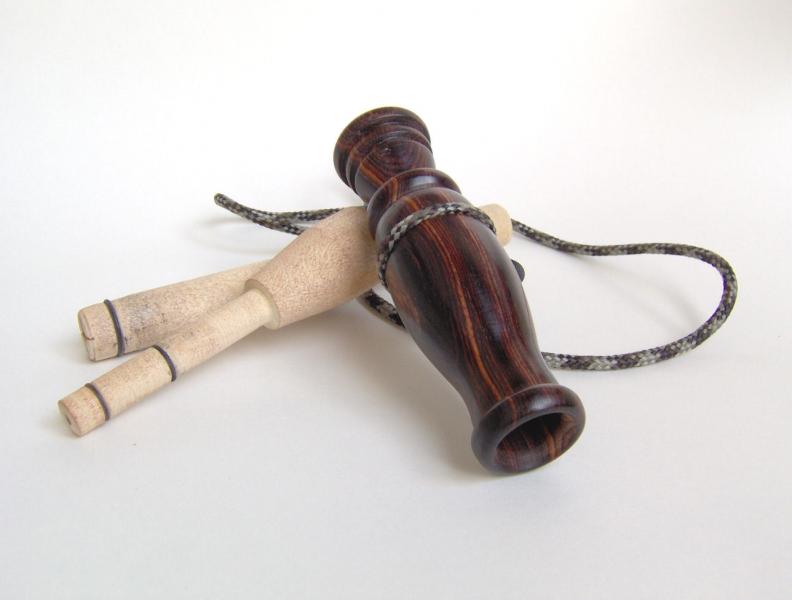

Here is a duck call i made from Hut, i got the complete kit but did not like the rubber expansion mandrel thingy so i made my own from wood. Gave it to an avid duck hunter friend and he raved about the sound from it. Made a lot, but used Echo inserts for goose and duck. Since bought brass mandrels made some more calls and now lost some interest, will pick up again. Carl
