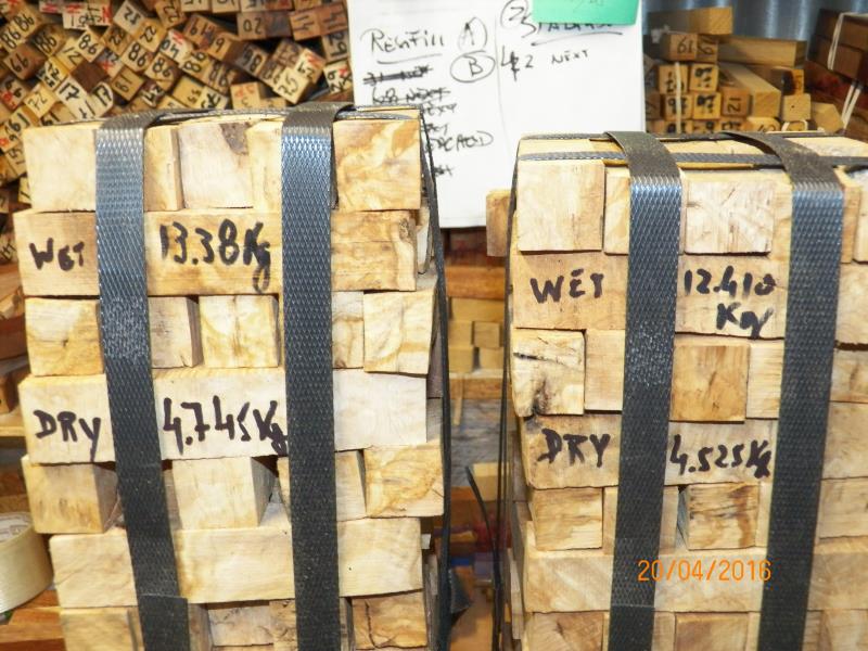

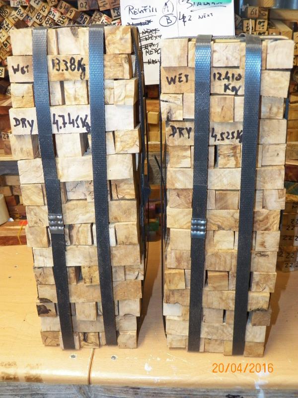

I had 2 of my "drying towers" and many lose pen blanks, I have weight each of those 2 towers before I put them in the oven, when I toke them out and re-weigh them, it was obvious the weight loss the wood have, nearly 2/3 of the wet weight lost, see pic I took about an hour ago.
