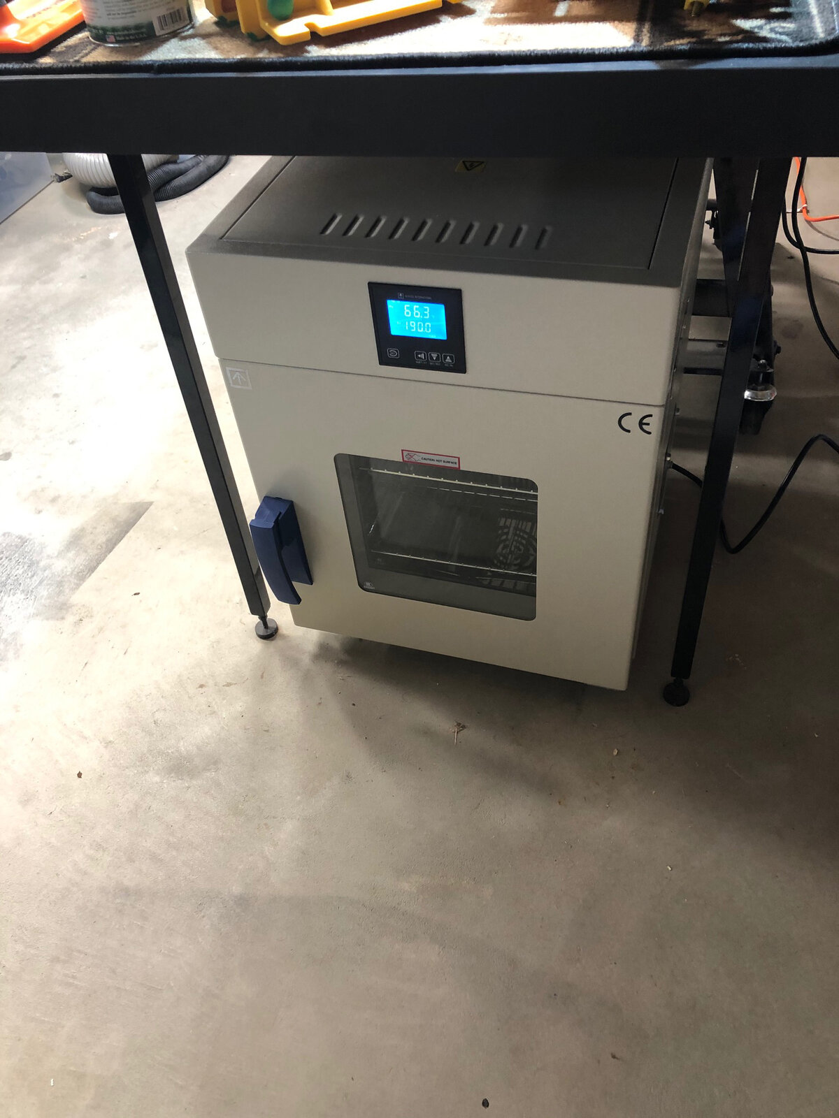

It is an Across International forced air convection oven. It is basically brand new and I got it through Craigslist when I was looking for a toaster oven. I got it from a lab that was liquidating equipment and it cost about the same price as a big toaster oven.

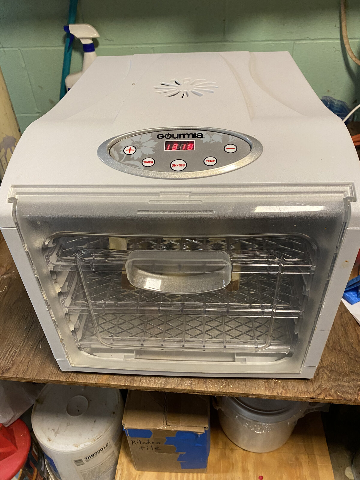

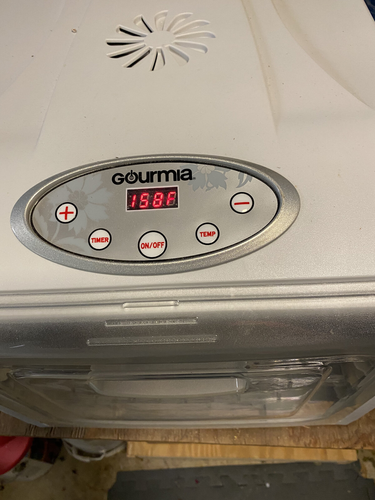

My son bought a food dehydrator so he could make his own jerky. Turns out that it is way more pain than gain, according to him. So, I inherited the device.
It's great for drying wood. Has a timer that can be set up to 19.5 hours and max temperature to 158 degrees. Depending on the wetness of the wood I might have to run pieces through three or four cycles. Using it now to dry some freshly cut mulberry.
I weigh the wood, run in dehydrator and then re-weigh. When there is no more drop in weight I can then move to the lathe!!! Works great and is safe.
