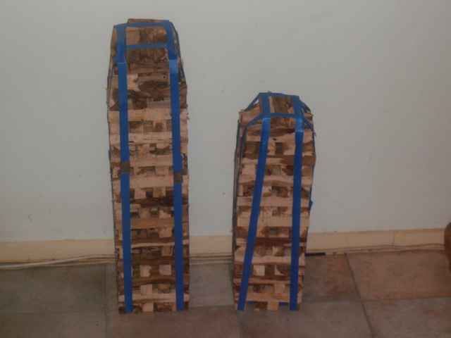

Your best bet and safer way to dry the burl as fast as possible by natural air dry to start with, would be for you the slice that burl into sightly oversize pen blanks. I know that you cut you blanks a little thinner than mine but, I cut mine green at 22+mm square x 135mm long for final size of about 21mm x 130mm.
I recommend those 5mm extra in length as, some woods/burls tend to shrink considerably more in the length than in the width.

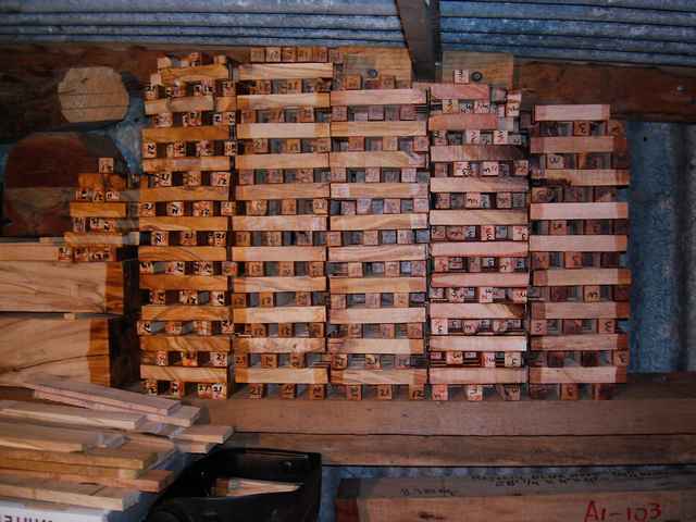

After you have them cut, stack them up in cross layers and with a gad in between each blank (normally 5 on the bottom and then 4 on each layer) building up what I call a "drying tower" , not going over 2' in height (stability while unstrapped) then using either some packing blue plastic webbing/strap, wire or anything else you may have that is capable to be strapped tight, in one or 2 straps on each side (pic attached).
You can also build these "racked" piles on a shelve or place where they are not going to be knocked over, something that did happen to me a lot initially, reason why I prefer to strap these bundles as it makes extremely easy to handle them and store, either upright (preferentially) or on their side if necessary...!
You will find that, with the temps you have in your neck of the woods, the banks will be workable to dry, between 6 and 9 months.

NOTE: Do never put your drying towers in the sun, with the intent to get them to dry faster. They will but, you may endup with little or no blanks to sell, afterwards...!:eek::mad:
