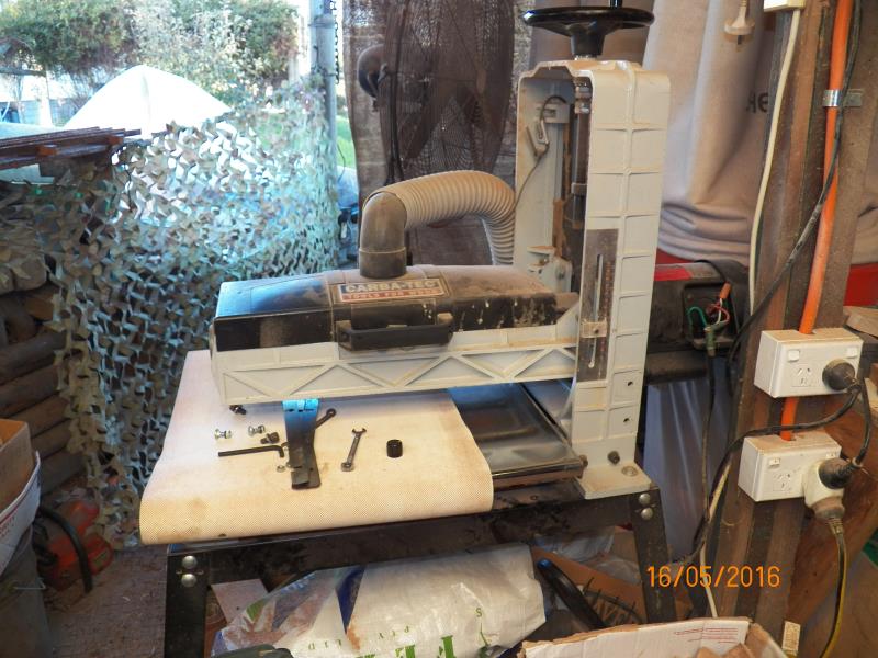

Hi peoples,
Workshop equipment failures and problems are as old as tools themselves so, most of you like me is not new to that but, it always happens at the wrong times, huh...?? (is ever a good time..??:mad:)
Well yesterday, my Carbatec drum sander, one of these WDS-400.jpg decided that would stop for good, what I mean is, about 1 year after I got it, I started to notice some considerable loss of power on the main sanding drum motor to the point where the safety heat button would turn the motor off at the least sign of the drum starting to bog.
I reduced the amount of wood sanding to a minimum each pass but even that, would kick that switch/button to quick so, I decided to bypass that switch that had become far too sensitive and continue using the machine.
The lack of power was really getting low and I was spending far too much time making several passes when one should have been sufficient but, I did not realise that every time the drum jammed the wood, the table conveyor belt would either stop turning or spin the belt under the wood but not strong enough to push the wood from the jam.
I contacted Carbatec late last year, just before I got sick, the machine had 3 years warranty and about 18 months use so, I spoke to the guy that actually sold the machine to me and requested a possible solution for the main problem that at the time was the main sanding drum motor.
We spoke about the possibility to have their technician to come on site from Adelaide (about 70km away) and check the motor but that visit would cost me unless I would take the machine to their shop for testing.
The damn thing is heavy for me and I was using it almost daily so, I considered what would be the best option, take the machine to them have the motor possibly replaced and be without a machine for some weeks or, continue using it and when it would burn, I was considering to buy a stronger motor for it, the 1Hp is just not enough.
I then got sick and the last thing on my mind was the damn machine so, months later, and with so much work to catch up, I have been using that sander quite a lot until yesterday when, halfway through one lot of pen blanks, the table conveyor belt stop turning, while the main drum sander was still going but obviously, the wood got jammed.

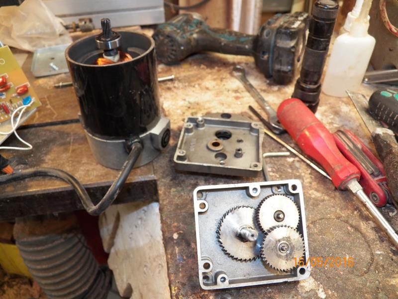

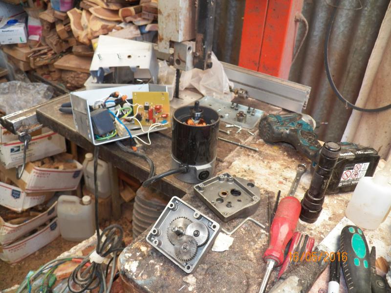

The small motor that runs that table belt seemed that was not turning so, I reduce the belt tension and tried again and this time, the whole power to the shed went out:confused:
Tried again, the same result so, I had to try find the problem and with some luck fix it. It took me a little while to figure out how to dismantle that small motor and attached gearbox, I had to undo a lot more bolts and screws than I ever though but after some time, I had the whole thing out.

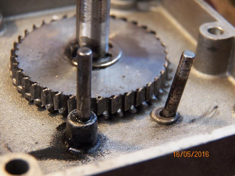

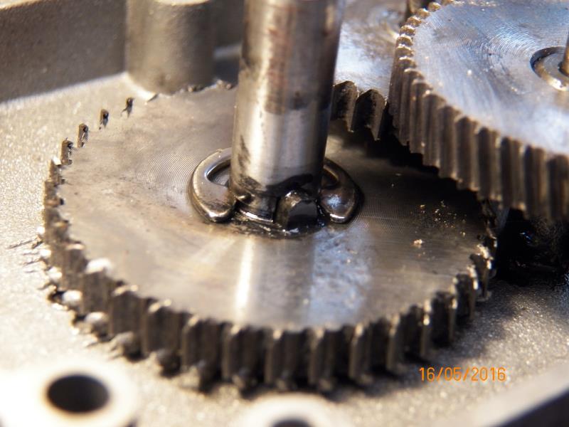

The motor brushes seemed OK so, that was not the problem, the "finger joint" between the gear box and the rod that turns the belt seemed OK so, it had to be something inside the gearbox.
Was not lack of grease, it had plenty but I could see immediately that, the bottom cog that engages the motor shaft was chewed up pretty bad. Cleaning all the grease, it became obvious that the whole gear box was stuffed, cogs and pins were all damaged.
There was nothing else I could do then contact Carbatec and tell them the news. I told them that I had some pics of what I had found and that I was going to send them for their viewing and deliberation.
What are they going to do...?? I have no idea, are they going to send me a new gearbox so that I can put the machine back together..?? and about the problem with the main motor loss of power..??? after all, was that constant jamming that caused the cogs to strip so, a new gearbox is not going to resolve all the problems with that machine so, what will they do..???
Are they going to void the warranty because I worked on the machine? possibly, are they going to replace it? I doubt.
I wouldn't mind an upgrade to an identical size machine from Jet, the 16-32, same drum size and belts that I have a lot spare however, what am I going to do with this one and, it's a $1,500 investment that I could do without, at the moment.:redface:
I haven't heard anything from them today, I need to wait and see what they are willing to do, the one way or the other, I need a working machine here, ASAP so, is not going to be fun, for sure...!
Here are the pics I took;

Three year Warrenty? Used two years? Sounds like the company needs to help you out. I understand that you are busy George. However, there are times we just have to bite the bullet. Do you have a young neighbor that would help you load the machine?
Personally........I would take it back and ask for a loaner.....or buy another bigger one and get back to work. I would also have them fix this machine and set it up also.
Now you would have two machines and could keep going even if one breaks down. And if the problem is the machine itself........Maybe it is time to upgrade to a better sander.
Sorry to hear all the problems but sadly, sometimes the only answer is the one we don't want to do. That is spend more money. But in the long run we are happier and get more done in the future.
Best of Luck,
Yes, I agreed with you, sometimes we have to do what we don't want however, the situations decide the determining factors and choices have to be made.
There is always the issue between DIY and Industrial equipment, not always the prices are the determining factor, machine sizes Vs workshop room/space available do sometimes play a big role, big machines are stronger and more durable but they can an overkill in some situations, running costs can also enter the equation a good example of that was my upgrade from a single bag 3/4Hp dust collector to the industrial double bag 3Hp unit, I was in shock when my power bill increase 25% after I started running that unit daily or nearly...!:mad:
There is also the very true fact that, most of us try to use DIY tools that were not made to work as hard as we push them, we are all guilty of that.

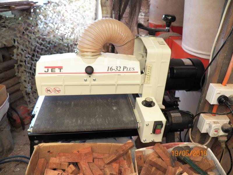

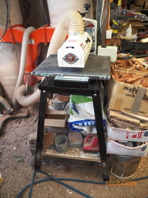

New Jet working
Hi peoples,
As mentioned on my last post, the courier came and conquered so, the new jet is up and running and with a dozen hours of work on it.
I'm using the stand from the other sander, the Jet stand is very low for my likings so, I endup using the bottom metal tray of the Jet stand to put on top of the old stand as the Jet is a lot narrower but similar lengths.
Bolted it all down, adjusted drum to the table, put a 36 grit belt of it and Bob was your uncle...!:biggrin:
Interesting that, the conveyor belt on the rotating table, is made of some weird course material looking like a wide sanding belt of 60 grit or so, it grabs like hell...!
I'm pleased that, in times of need, there is always someone willing to give you a hand minimize the difficulties however, reaching that position, has been a careful and constant working to maintain my good name and character with everyone I dealt through the years, hard work sometimes but very rewarding in the end.
I'm going to try upload a couple of pics I took of the new machine from this Tablet, my home pc and Internet connection has been down all day so, I use the Tablet on emergencies like this.
All back to normal again, plenty of sanding to do...!

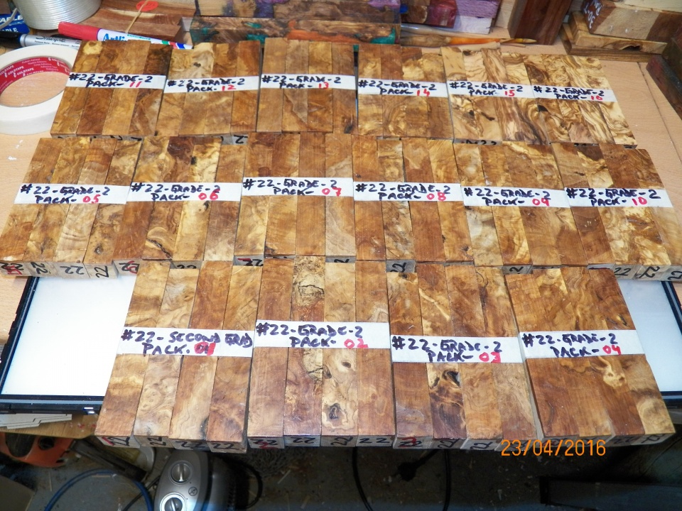

Let's test it shall we...??
I'm going to add here, a bunch of pics of the type blanks I'm talking about, let's see if anyone is interested, if they are, I will sell them here, no problem...!

Well, this morning I received and email from Cabatec with the deliberation on the repair issue of my drum sander after 2 years use and with 3 years warranty.
While disappointed, I'm in no way surprised with their decision to cancel the warranty because I basically touched it, pull it apart. Their focus or should I say, the point the hold on to justify their decision was that, I bypassed the motor safety switch and therefore caused the gearbox to self-destroy.
They offered to repair it at my own cost and the quote was for "in excess of $450.00" according to their own words...!:eek::frown:
I was expecting something like that, so, nothing new.
I have requested that they give me a cost for the parts I need so that I can fix it myself, their labour hourly rates are very hight so, I will get it repaired.
It Happens that, I had to take Merissa this morning to the Repatriation hospital for her monthly Infusion so, I used the opportunity to drive to Carbatec in the 2 hours I had of waiting so that turned out OK.
Parts ordered are, gearbox, safety switch and the capacitor with those replaced, the machine should be back to perfect working order, again...! and if the parts cost far too much, I will put it aside as spares...!
