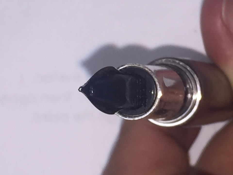

Sorry for the late reply, been really busy the last week or so. I was able to shift the nib a little and it writes a lot better. Here is a before picture of that helps:

Definitely looks like the tips aren't aligned. If I'm seeing correctly the right tine is bent up. To confirm make some horizontal lines (crosshatch) from left to right and then the reverse. If I'm correct then you will feel the drag when drawing to the right and it will feel smooth going to the left. As a start, using only your fingers "NO Pliers", bend down the right or in the picture the bottom nib a bit more to line up the tines. The video referenced above is a good source for info on tuning. Also check out Fountain Pen 101 on GouletPens.com
