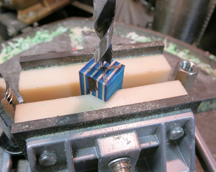

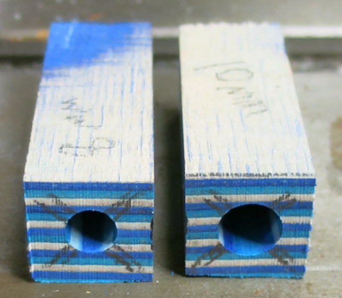

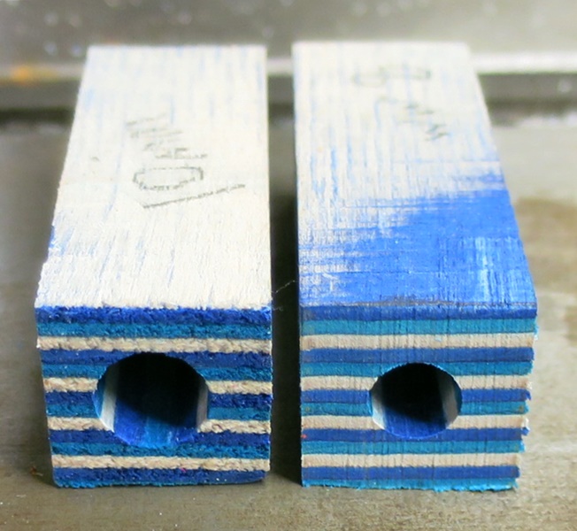

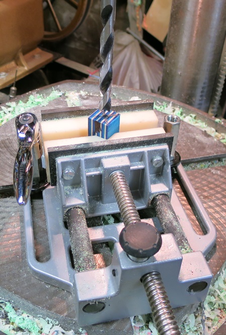

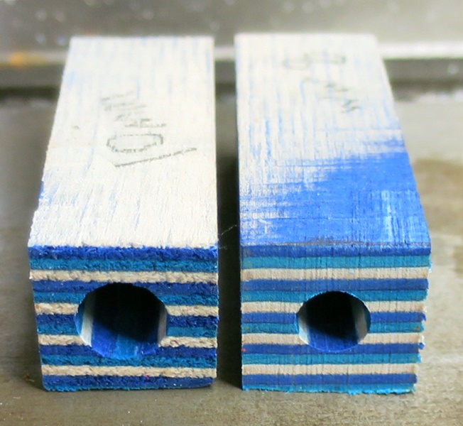

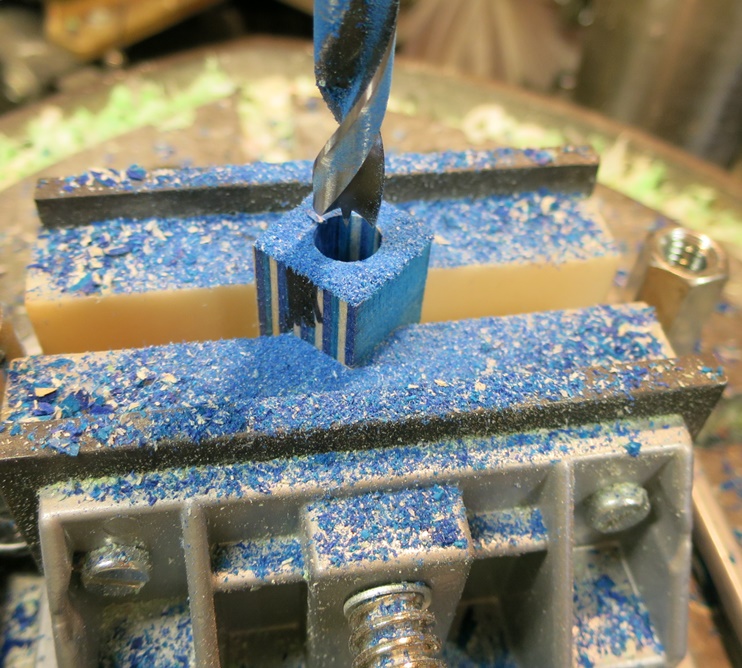

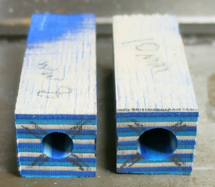

I've only drilled a couple of SpectraPly blanks, but haven't had any problems. They drilled like any other blanks. One of these is 8mm, and the other is 10mm.

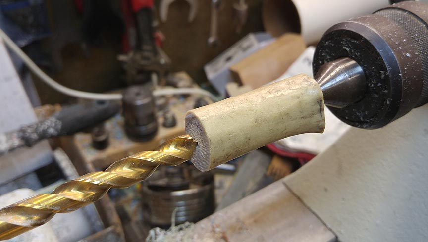

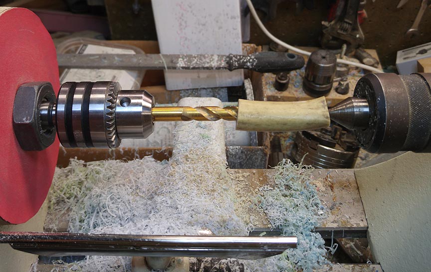

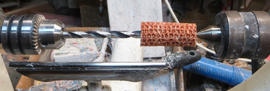

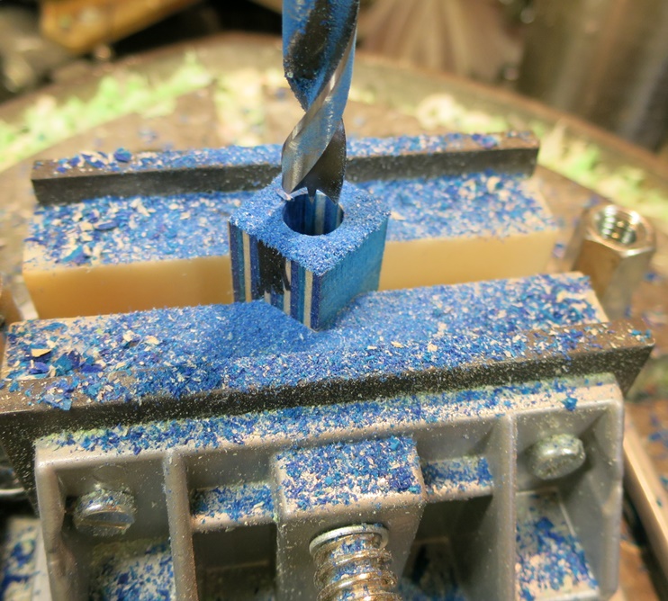

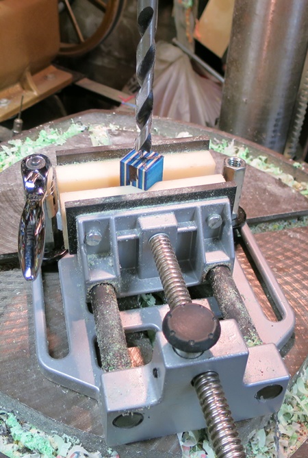

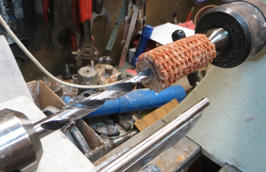

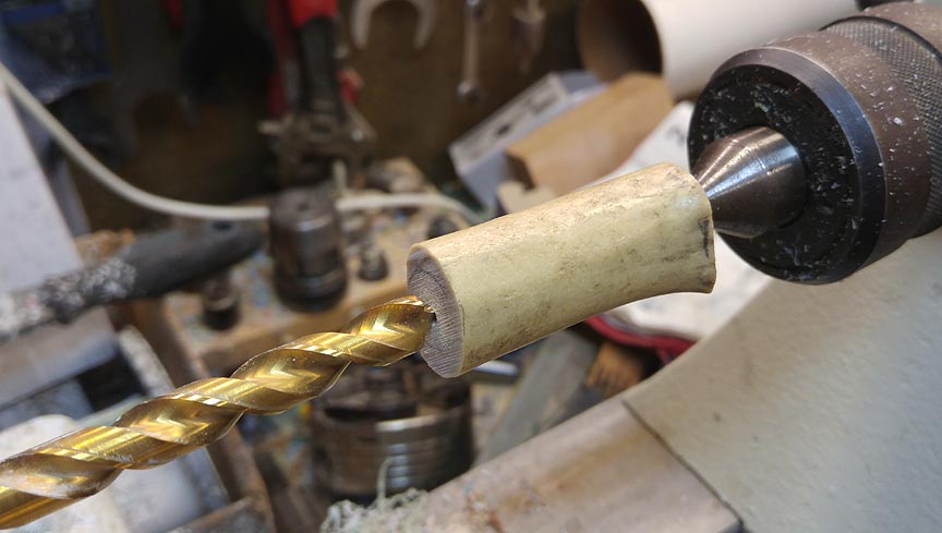

I always drill pens, razors and seam ripper blanks on the lathe. Until I can afford a real drill press and replace my aging HF benchtop model, I will continue to use my lathe. I will try a non colt just to be sure, but the angled segments and harder glue reasoning seems to be spot on. With each layer of glue the bit probably wanders down slope and then starts though another layer of wood. The result is a bit off and am seeing. The damn blanks make pretty pen and they are cheap, nice combination if people with money buy them.

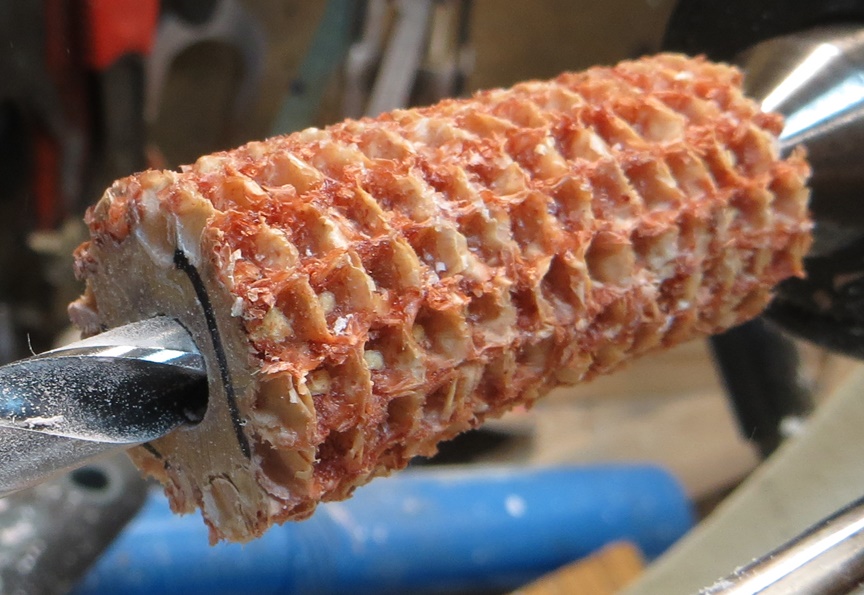

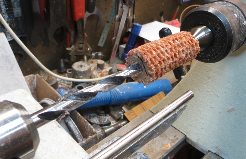

Thanks for that link. He does get what he wants every time with that method. If it seems safe and doesn't damage the softer color grain I'll try it.

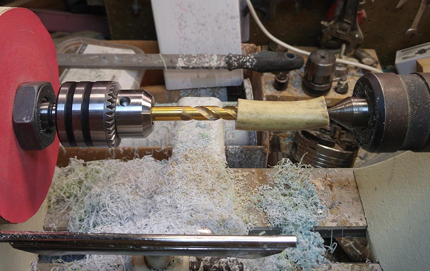

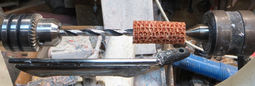

The video of drilling the antler blank seems to be an interesting way to fix much of the issues of drills going off center, if it works properly with slightly substandard equipment (like a mildly dull drill bit). I'm going to have to try that, next time I'm working on an antler blank.
