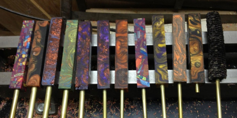

I drill one long hole (with a long bit) and glue in a single 10" replacement tube for most of the kits I make. My drill press has almost 5" of quill travel which is perfect for not-quite drilling out the other end.
Back when I'd cut the blank into shorter pieces, I usually drilled all the way through each half. That lead to more blowouts when the bit exits the bottom of each half. A common suggestion for avoiding that was to "drill short" (i.e.: don't drill all the way out the far end).
Long bits, excellent quill travel, and single piece long tubes makes that easy to do. Each 10" piece of brass tube will easily do two normal length blanks.
After the glue sets, I trim a hair off the end of the blank that has the tube sticking out and I mill that flat. Then I mark it for length plus a hair and cut...mill both sides of the cut flat then mark for the second segment, cut and mill its end.
This gives me more control over how much gap I want in the patter where it cross the center band (for pen styles where that matters).
I've attached an image showing a batch of blanks drilled and glued this way. The second blank from the right has only a little stub sticking out so that one's tube is likely the leftover from a prior batch.
