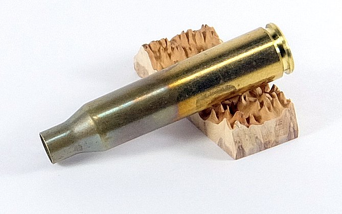

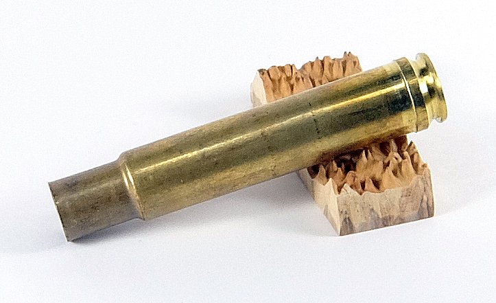

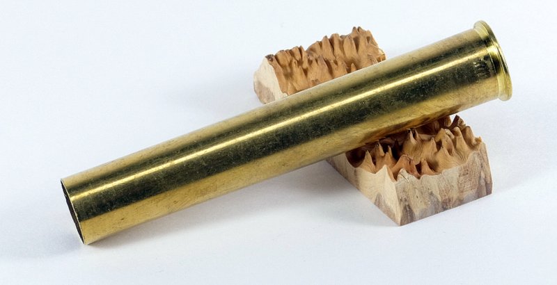

Centre drills work wonders mind you I simply use DeWalt Extreme 2 with outstanding success for blanks and cartridges.
I am about to give these brasses a workout. From bigns to whoppers.
Peter.
