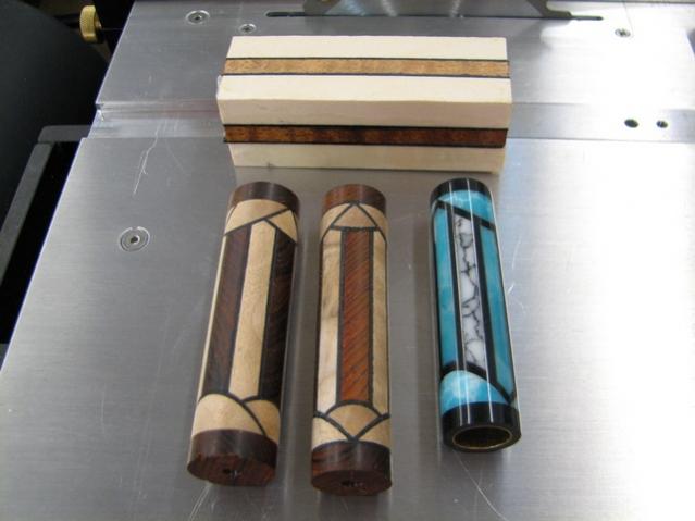

I draw lines, using the pattern of the blank, all the way to the ends, and then transfer the lines TO the end. Marking the end with an "X" doesn't work unless your blank and pattern are PERFECTLY square, good luck with that!:wink:
I then center punch the mark and make a small dimple with a center drill. I put it between centers and turn it round and then put it in my Beall collet chuck for the drilling. I usually drill in three steps, 1/4" to start, then I pick a drill about half way between 1/4" and the final size and then the final size. It's a process that works for me so far.
Here's a sample....
The lines I was talking about are the long straight black veneers between segments. If you always work from the "center-out" you won't have any off center issues.
