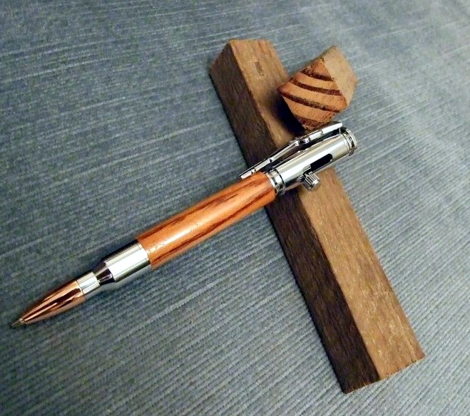

That's my concern, not that it's much layout but there's tons of things we can spend $10-$50 when $0 will do the trick. Pretty much all I'm going to be doing for now it precut wood blanks and some acrylic, round and square stock. I've drilled one of the heart pine blanks in the attached pic with no issue, they aren't perfectly shaped, a little pitting etc but not bad. What materials can you say it would be a need? Thanks for the reply BTW
