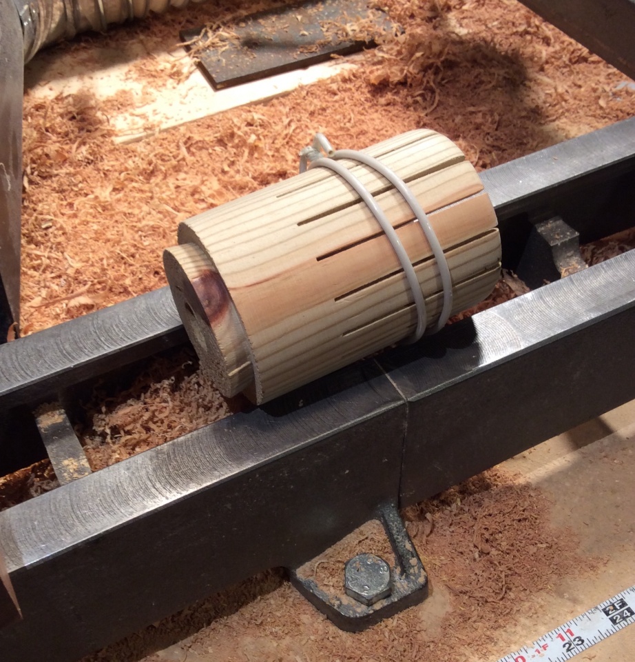

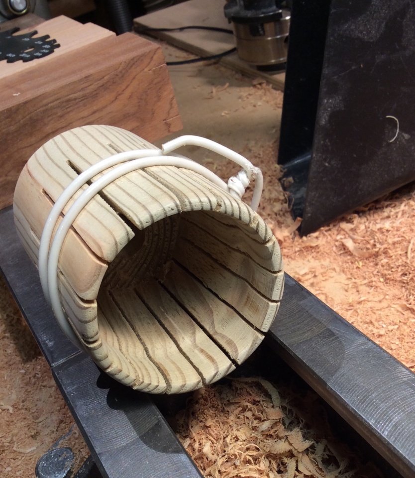

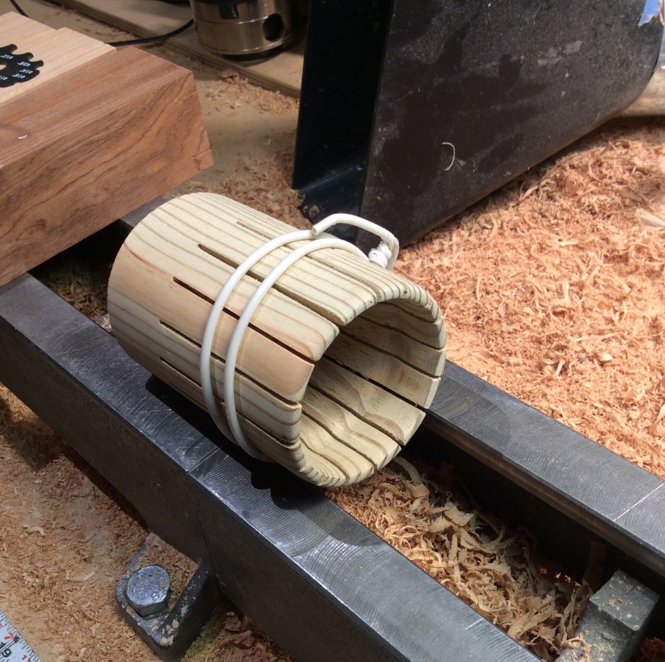

Last year, I made a quick sphere chuck so I could drill and also, turn the foot on a sphere.

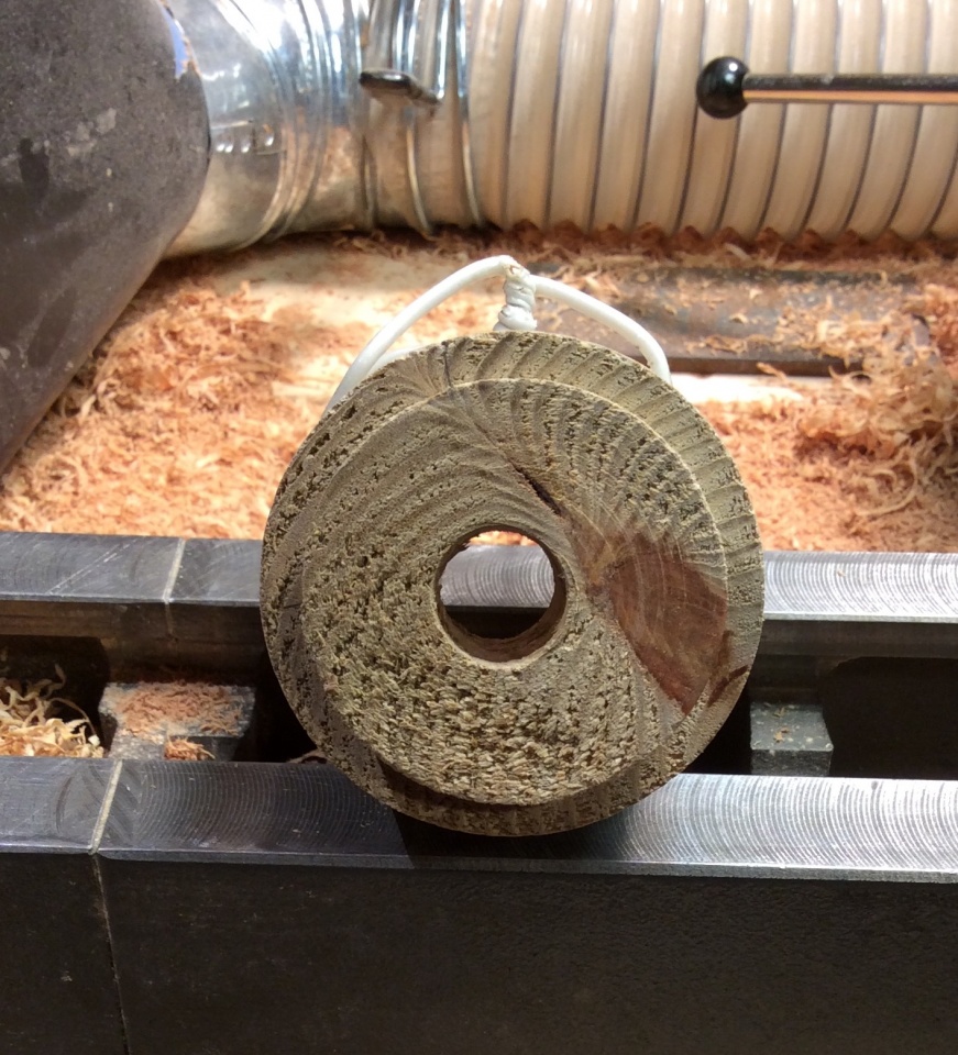

Notice the internal recess to hold the sphere in place. I brought the tail stock up to pinpoint the correct location center which I had decided upon.
I used the twisted wire as a clamp to avoid the lug and band of the hose clamp.
Since I was clamping a sanded sphere, I packed a rag in behind the sphere and used the hole in the back on the Dovetail side to slide a dowel through against the rag so I would not damage the sanded sphere as I pushed it out.
This was for a desk pen base. I drilled for the pen nib, flared the drilled hole accordingly, remounted the sphere to turn the foot in a location to give the proper angle for the pen when in the base.

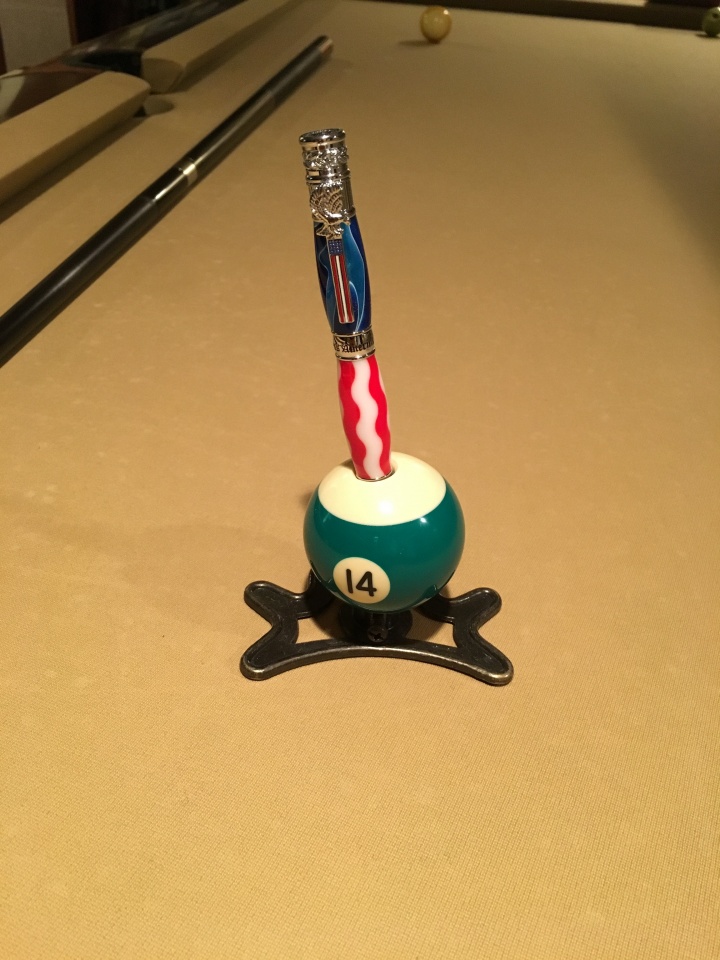

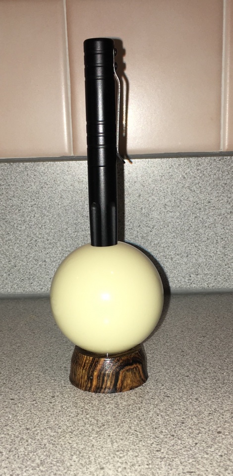

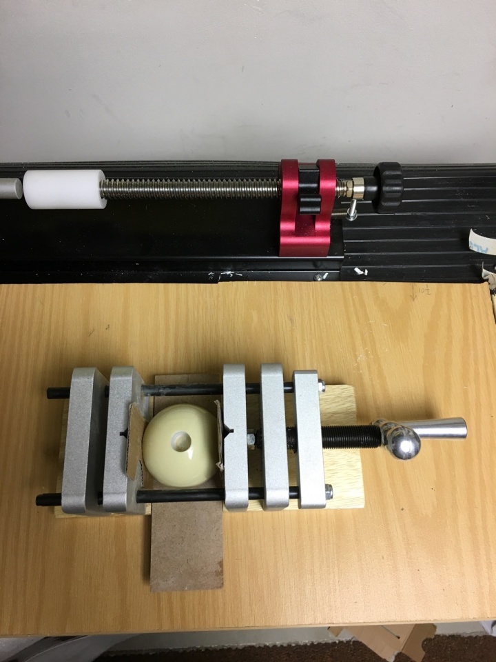

Worked out nice and easy. Balls are cheap plastic. About $29 a set of 16. Drilling went smoothly... My pool buddies are in for a treat.
Base on cueball is a cut off from a bottle stopper. Pen is a Schrade tactical pen.
I used this holder ...put a piece of cardboard on each side of ball...snugged up to hold firmly.
