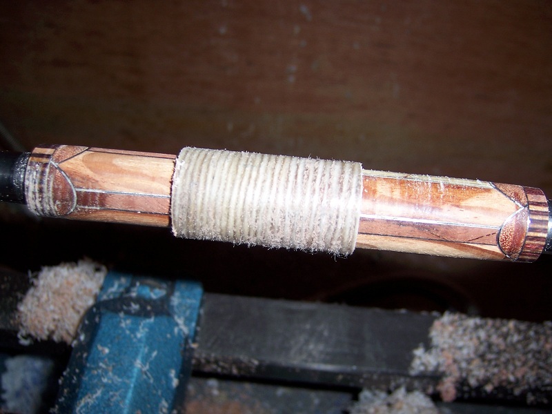

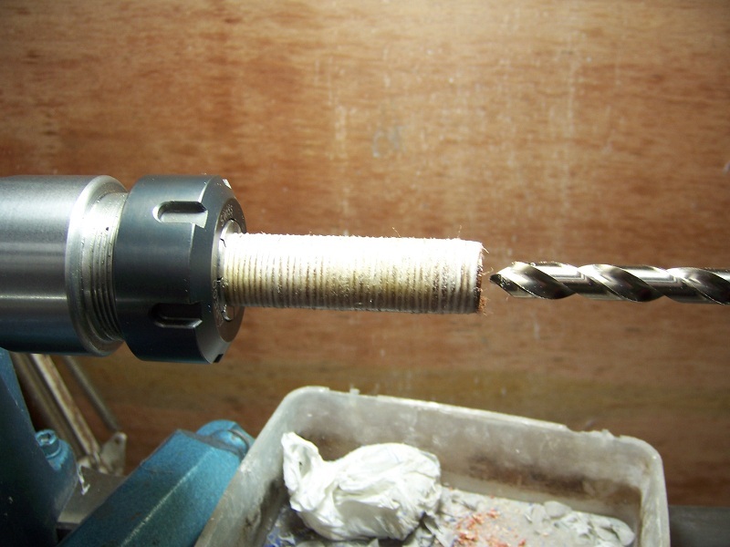

this takes time, CA glue wooden ice cream pop sticks too the 4 sides about 8 sticks if its 3/4, now if you can to drill on the lathe use a center drill on the ends of the blank then turn the blank round between the lathes dead center and live center when the blank is round wrap the blank a few times with string and soak with CA and spray the hardener,you can make it as thick as you like it's up too you, use a mask and eye glasses string and CA gets alot of fumes coming off, once the string sets its tough as nails

brilliant idea . I've used string and epoxy to reinforce / firm a pleasant handgrip on tool handles but never though of CA to reinforce section of blank.

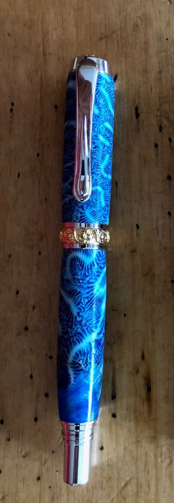

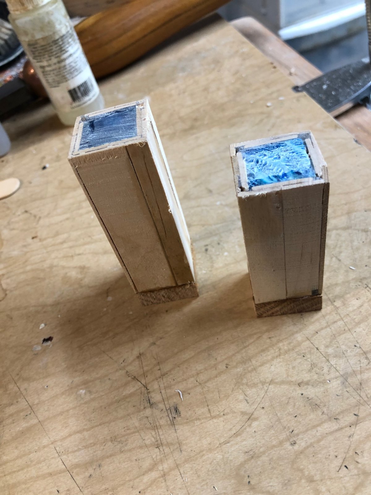

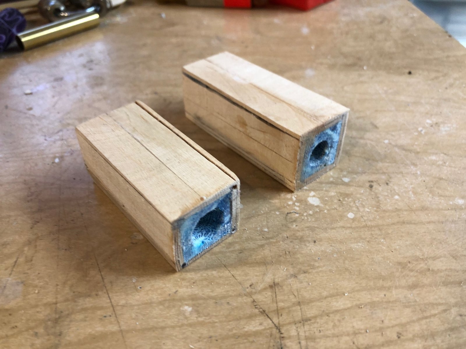

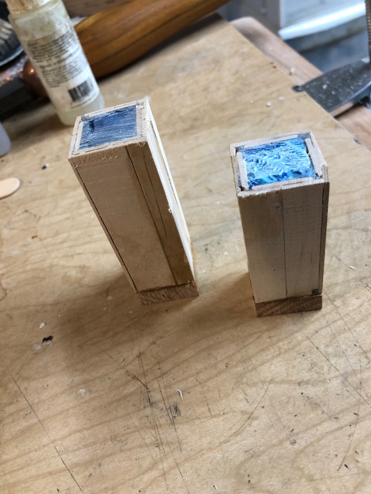

Success, I did get the pen turned and assembled. The first photo shows the blank with two layers of tongue depressors glue on. that held it together during drilling. I drilled pilot holes with a 7 MM bit, re-sharpened it twice while drilling each section. then drilled the holes larger to the final diameter, that took two more bit sharpening jobs for each section. I turned it with a carbide cutter. The cutter has four sides. I started with a new cutter, used three sides to turn the thicker section, used the fourth side then re-sharpened the cutter and dulled all four sides again before I got the thinner section turned. I filed out the inside of the tubes so there was no pressure on the tube during assemble. Then I used epoxy to glue the parts on. I was concerned that any pressure in assemble would fracture the hard coral.
I turn a lot of pens, I'm accustom to spending hours building a blank, but spending hours turning is unusual. Total turning time for the two sections combined was about 4 hours. Making a pass with the turning tool was like removing a light layer of dust, it was slow work. I normally spend 2-3 minutes turning each section of a pen like this, half that time if it is going well..
It turned out well, I'm not happy that on the finial end where there is no coral, but I didn't make the blank, that is all the coral there was to work with. I glued a block of wood on the bottom of the tongue depressors so I could drill through all the way through the bottom of the blanks and into the wood.

Glorious !!!!!
Thanks for showing the result, plus some intermediate stages .... Well done !!!!
I like the nice pattern matching across the center band also !!!!

Here is another photo I should have shared earlier. What I want to point out here is the little blocks of wood on the bottom of these two sections. I like to stop short of drilling all the way through and cut to length later. I didn't have enough length to do that here, I glued on the block to. the bottom so when the bit went through the bottom it went into the wood to prevent a blow out. Even if I had enough length to stop short and cut it off, I didn't want to do that, I destroyed one band saw blade just cutting it in half. I squared the ends with a Rick Harrell sanding jig.

LOL Another one of those things I never would have noticed if you hadn't pointed it out. Gorgeous! I'm a diver. Never thought about casting coral. Gotta do it!
