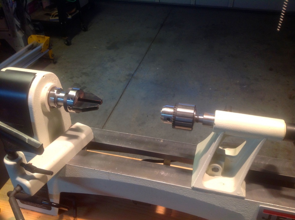

I have the same lathe...
...and here is a picture of my set up. The only thing I would change is I should have purchased the larger Pen Blank Drilling Chuck. I have the 1" capacity and I wish I had purchased the 2 1/2" capacity one. They are available at Penn State.
I chose this method of drilling because I have a small drill press and cannot get enough 'throw' to drill completely through the blank without moving something. That adds too much of a possibility of error for my taste. Others may be successful at that, but not me.
This works well for me, and I hope it will for you!

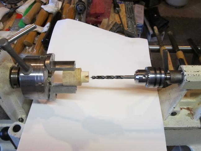

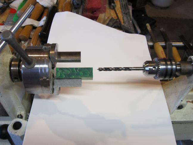

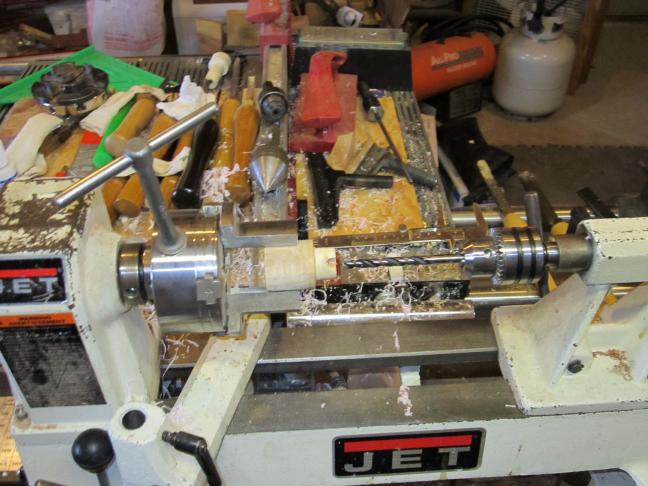

I also have the Jet 1014vs...I went with the Nova G3 chuck and added their pen blank Jaws. The first two pics are of a jam chuck I used for bird houses. The chuck is 1 1/2 in diameter...Pic 3 is with a pen blank. I also have the different size jaws that came with the chuck. I like the T handle wrench over my Barracuda's tommy bars. With the G3 you aren't restricted to just drilling pen blanks...
