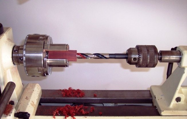

If you have a scroll chuck and a jacobs chuck I would drill it on the lathe. See attached picture. Best way to find the center and drill it straight.

I use a lathe with a scroll chuck and a set of #1 jaws to hold the blank in place. No need to worry about centering the blank because it is automatically done. Straight grain wood is no problem, I can get a hole perfectly in the center every time. The problem I have run into is when I hit a section of wood where the grain running in a different direction. Sometimes the bit will wander off. This is the problem you will run into with your blank.
While the blank is spinning in the chuck, I take a skew and make a divot in the center of the blank. This helps the bit to find the exact center. I move the tail stock with the bit install and the quill locked down up to the blank and let it lightly touch the blank.
As soon as the tail stock stops dancing I lock it in place and start drilling to about a 3/8" depth, then I stop. I pull out the drill bit move the tail stock away and lock down the quill again. Now I "Push" the tail stock into the blank, using the hole I created as a guide and start drilling. I extract the bit every 1/4" inch or so. This works 99% of the time. Also, if you know how to sharpen drill bits, it would be a good idea to do so before you start.
BTW I run the lathe at about 750 RPMS (or what ever speed 1 in on a Jet 1236)
Good Luck!
