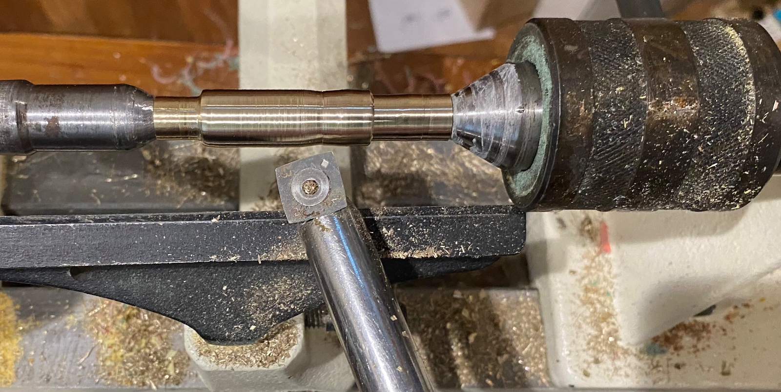

I square up all my pen parts on the lathe with this hand tool

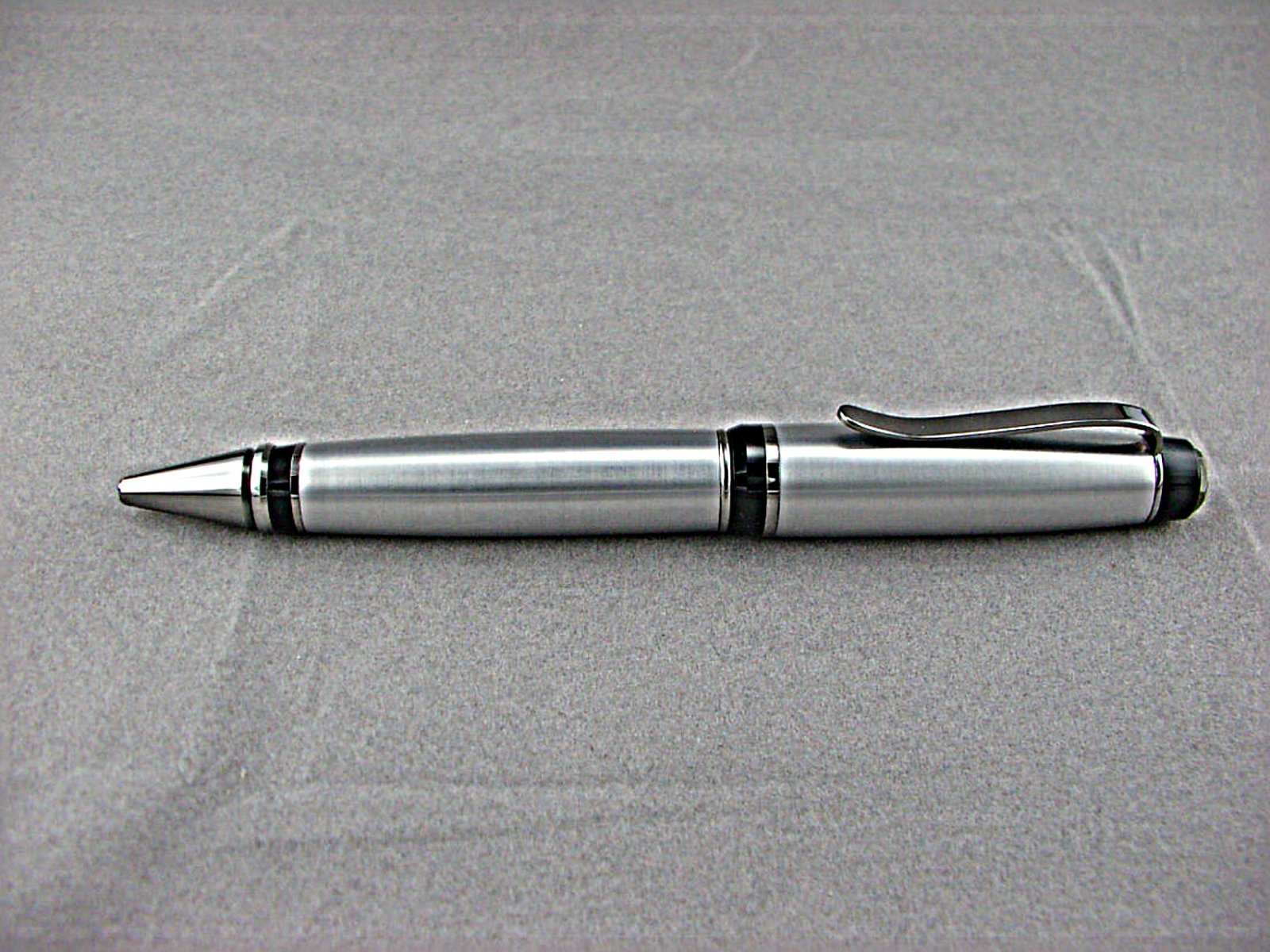

First the drill bits are no different than what is used for wood blanks except no brad points. Same procedures apply. The one thing that is important is to keep filings from getting into motor or lathe bed if drilling on the lathe. Clean up right after is a good idea. As fas as sand paper I use aluminum oxide paper. I like Norton brand. As far as needing to true up the ends, what is nice with metals you can be be pretty exact with measurements because they will not blow out on ends so keep it tight and less work after. I will square mostly using tools on the lathe. I sand to square ends on my lathe using the sand paper but start with about 40 grit and go from there. As far as glue, always epoxy glue. Now some people have used metals for pen blanks and acually did not use the tubes and just pressed the components into the metals. I use tubes because I do not have exact drill bits for components. As far as finishing and polishing, again the sandpaper is Norton. I use the black metal sandpaper when I get to finishing stages because it goes way higher in grit numbers. I like a brushed metal look as opposed to a highly polished lokk and for that I finish with a nonwoven pad which is about 400 grit on that scale. The second pen I show I did polish to a high shine because I polished both the acrylic and aluminum at the same time.
