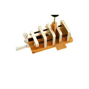

My shop is very small since I am currently living in a rented condo with a .95 car garage. To get myself started, I went to Harbor Freight and bought an inexpensive (I hesitate to say cheap) bench-top drill press. One of the guys who helped me get started told me I would live to regret that purchase. So far, I haven't but you never know what the future holds. I have been able to create work-arounds to compensate for the problems it raises. I have also seen others' shops on the forum who also use a bench-top DP. Currently, when I set up to drill blanks I check that the bit is running true to the plane of the blank, drill in about 3/4 of the way, stop the press, add a 2x4 shim under the blank-drilling vise, then complete the hole. It is a pain in the hiney to do it this way, but I am not doing volume work and it doesn't really present many problems. I have, however, ruined a few blanks by being off-plumb with the blank/bit orientation. Any and all suggestions to make my life easier, short of buying a full sized DP, would be greatly appreciated. Thank-you in advance.

As to the off-plumb issue - what are you using to hold the blank while drilling? A pen blank vise? Perhaps you could make some kind of L-shaped fence to maintain the alignment both laterally and longitudinally when raising the workpiece with the 2x4 shim.

The pen vise is just a standard vise that kinda looks like this:

OK, then the issue is just keeping the vise in the same X-Y location when you elevate it for the second stage of drilling. Perhaps build a simple jig from scrap wood to act as a fence on 2 perpendicular sides.
I think what you're saying is that you're placing a block of wood underneath the bottom of the base of your vise, raising up the entire vise and its base and throwing off the alignment. I have a suggestion: permanently mount 1-1/2" wood blocks under vise's two end support plates to increase the clearance from the bottom of the vise jaws to the the top of the base to which the vise is mounted. In other words... I believe the vise in the photo will accommodate a 1/4" thick sacrificial wood block between the bottom of the vise's jaws and the top of the vise's base. I'm suggesting that you increase that 1/4" clearance to 1-1/2" to 1-3/4". Then, once you have the jaws of the vise and the stroke of your drill press aligned in all three planes, clamp the vise in position, and they should remain aligned. One or more pieces of scrap slid underneath the blank would support the blank at the needed height for drilling without affecting the alignment. Might that work?
